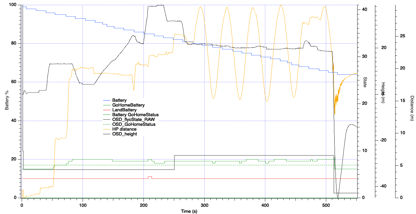

Here is the flight data from AirData GPS_Hotspot
Now I have never seen this option before with the term of GPS_Hotspot and was a little confused as to what it was in the flight data. After doing several Web searches I am still not confident as to what it really is.
SOOOO.... If you know what this is and can explain it, that would be great!!!!
I was up to date on software, used a POI, was in 5.8 mode. I also have the option of stopping motors turned off in the setting so it wasn't an emergency shut down! Kp index was 1.3

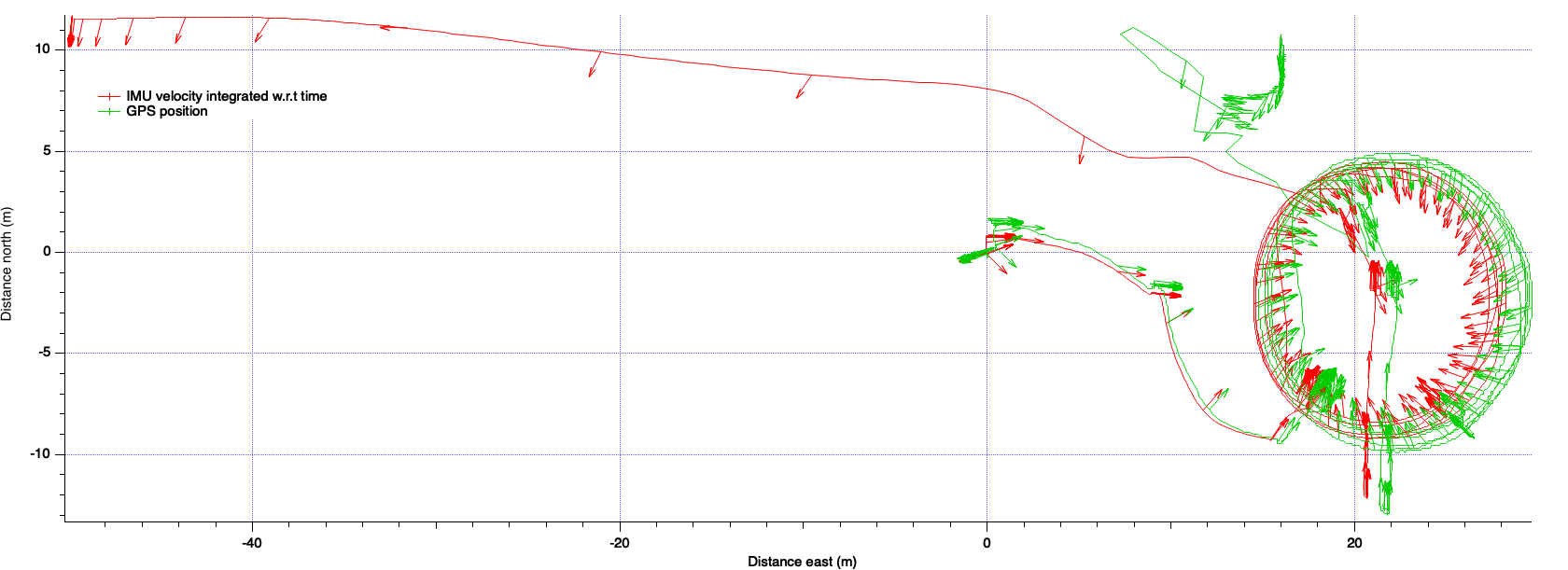

GPS_HotPoint (flycState = 0) is POI mode, so that was normal, until towards the end, when NavHealth went to zero and the IMU fusion solution for position and velocity went bad.
The FC started reporting compass errors at 420 seconds, although there is no obvious compass problem until 512 seconds, at which point the FC switches to ATTI.
That should have cured the flight control problem, but it didn't - the FC completely lost attitude and altitude control:

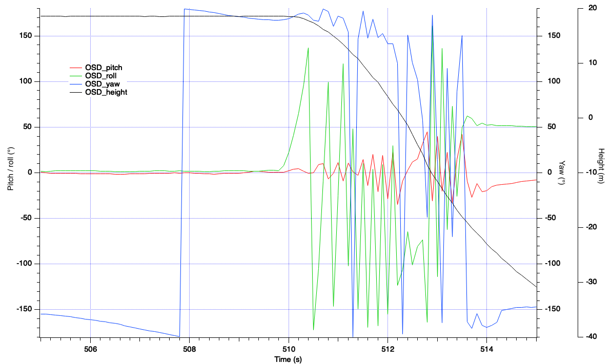

Here's what your flight data really looks like: DJI Flight Log Viewer - PhantomHelp.com
There's nothing unusual until 8:29.9 when the drone starts to roll.
Prior to that the roll angle had been 0° - +/-3° but at 8:29.9 it shows 8.1° and within half a second the drone has rolled upside down and is falling and tumbling.
All the error messages following that are due to the tumbling and are not indicating causes of the crash.
The drone doesn't spin which would indicate loss of a prop or motor.

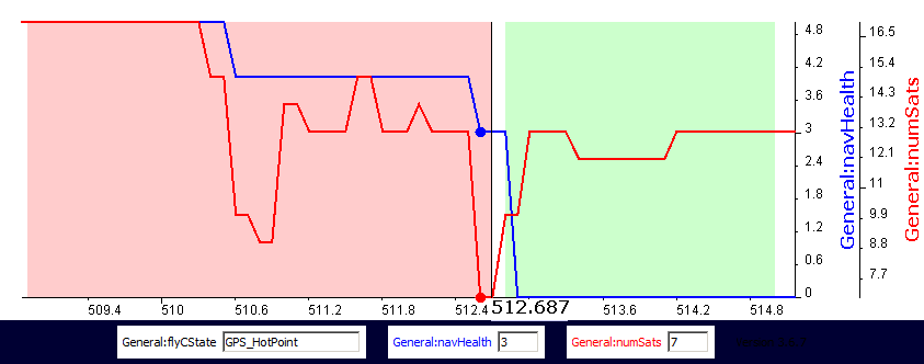

The switch to ATTI was caused by navHealth dropping to 3 which, in turn, was caused by a decrease in numSats.
Still doesn't explain the subsequent loss of attitude and altitude control.
