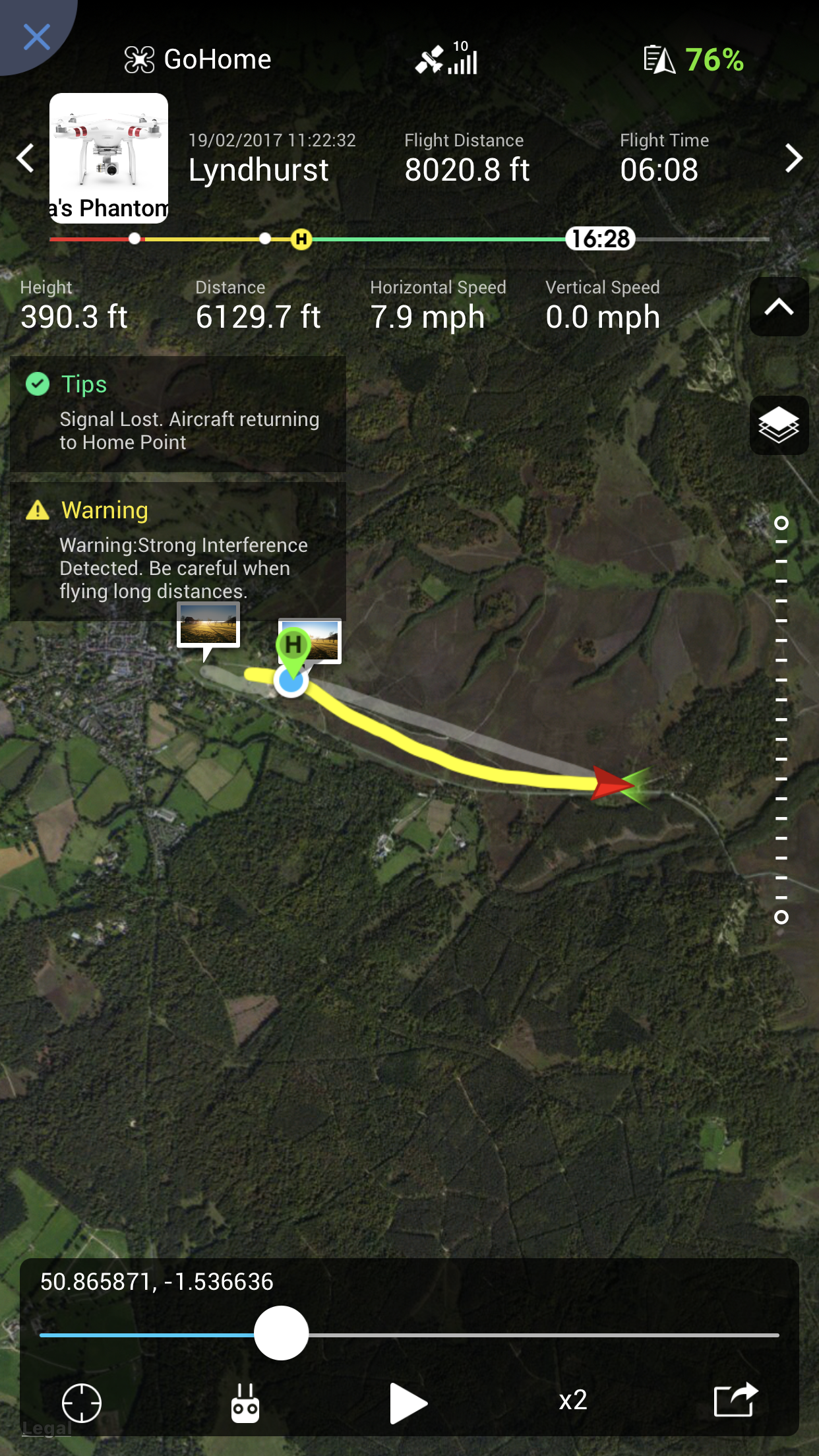

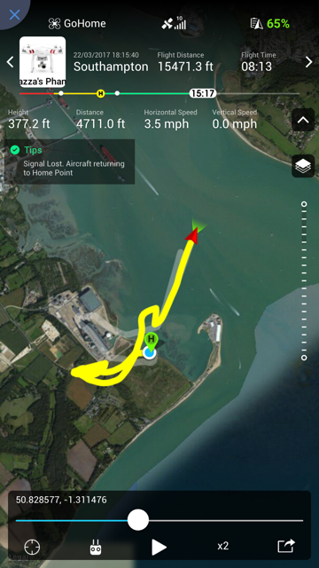

Wonder if any people know for sure, like what are the facts in what affcets the range of our drones?
Wondering if someone who is cleverer than me could maybe look at these two pics and maybe have any clue as to why my range was so different?
Range is affected, to some degree, by:
Weather, Solar Events, largely by Buildings/Trees/Mountains, and local WiFi interference.

without going into deep physics........RF of any freq is affected by lots of things........at 4000', you have exceeded the spec of 500 meters for the P3S by 100%.

But remember, if you are flying in a area with a bunch if interference nothing is going to help you with range. Same setup near the city only gets 5000' if im LUCKY.
As someone else just told you, radio transmissions are affected by a number of environmental factors. You can try to explain some of them, but the reality is that you can do absolutely nothing about it. Even in the same exact location, things change: most days your TV can tune on channel 104, one day it cannot. Most days your phone has 5 bars inside your house, some days it has only 2.
Asking "why I only reached 6000ft on flight B when on flight A I reached 15000ft" is the wrong way to approach this. The right way is "On flight A, location/conditions were perfect and I was able to reach 15000ft, on flight B location/conditions were much worse and I only made it to 6000ft.". And guess what? On flight C, you might get 10000ft.
Now, if you CONSISTENTLY get less range than what others CONSISTENTLY get, then you might have a problem with your equipment. But - as you just discovered - the very same equipment in the hands of the very same operator can give you radically different results, so you should not be so obsessed about this range thing.
