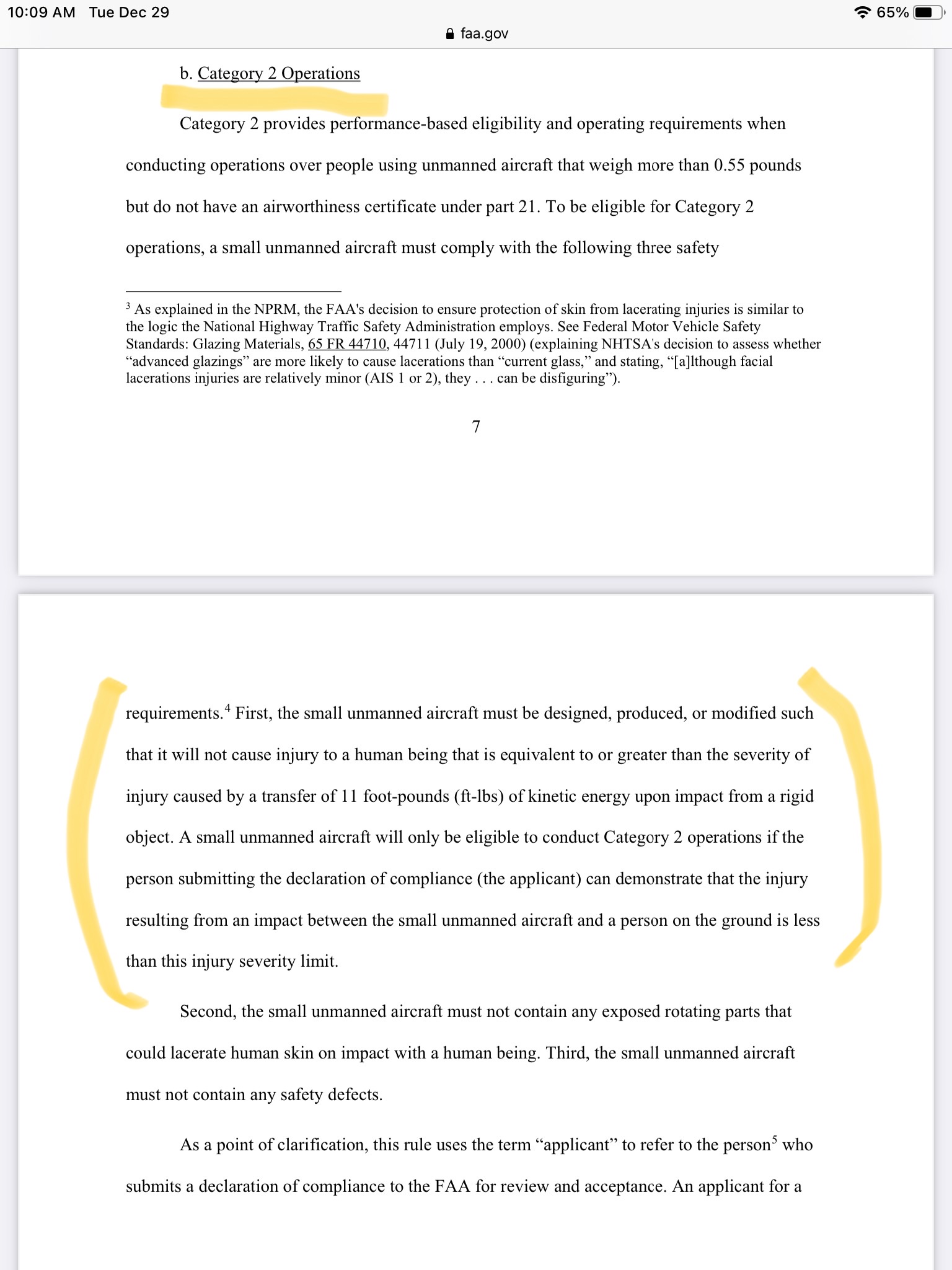

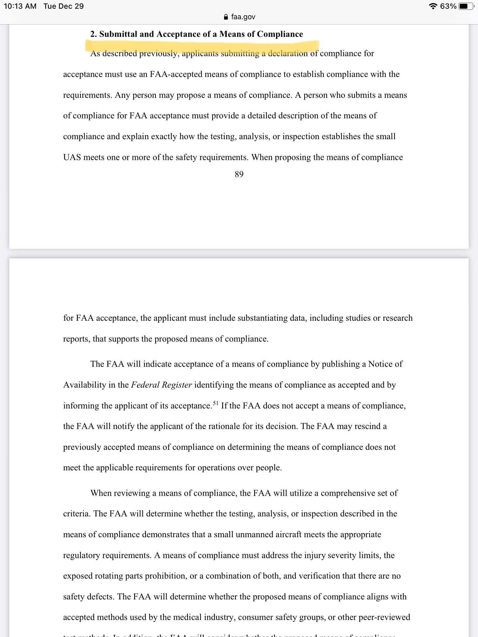

Prop guards are going to be the least of your worries. First you have to meet the first safety requirement and be able to provide a means of compliance acceptable to the FAA.

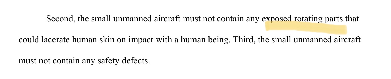

You won’t need prop guards if you can prove your drone’s props will not be rotating as it falls out of the sky. There is a product out there that meets the first safety requirement and has the declaration of compliance approved by the FAA and stops all four props as it falls out of the sky. But it comes at a steep price, you know what I’m talking about. Yes you won’t need a waiver but the proof of compliance for the phantom 4 is $1500.00 not including the product.
Maybe you can design a set of carbon fiber wings the pop out like a switchblade and glide that bird home. Just a thought.
