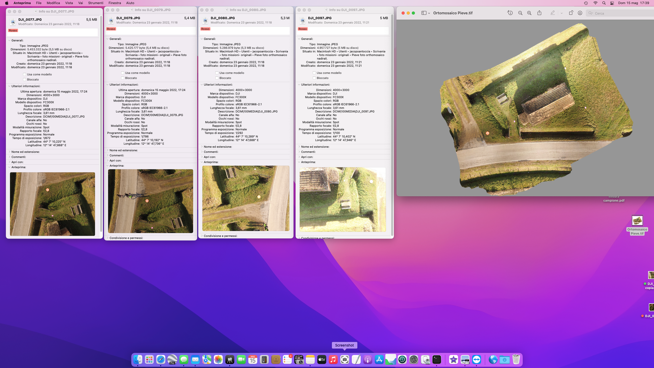

i' LL explain: I am using a DJI Phantom 3 Pro, with GS PRo for photogrammetry using Metashape .
That occurs , is that in the mission of Photogrammetry, the photos planned with the Automatic mission (GS pro- the setting of the camera in AUTO).
from the attached image you can see the various exposure times.
It is normal for you to have photos like this?

That looks like more exposure variation than you should be seeing.
The last two photos are overexposed.
When not using GSpro, does your camera autoexposure work properly?

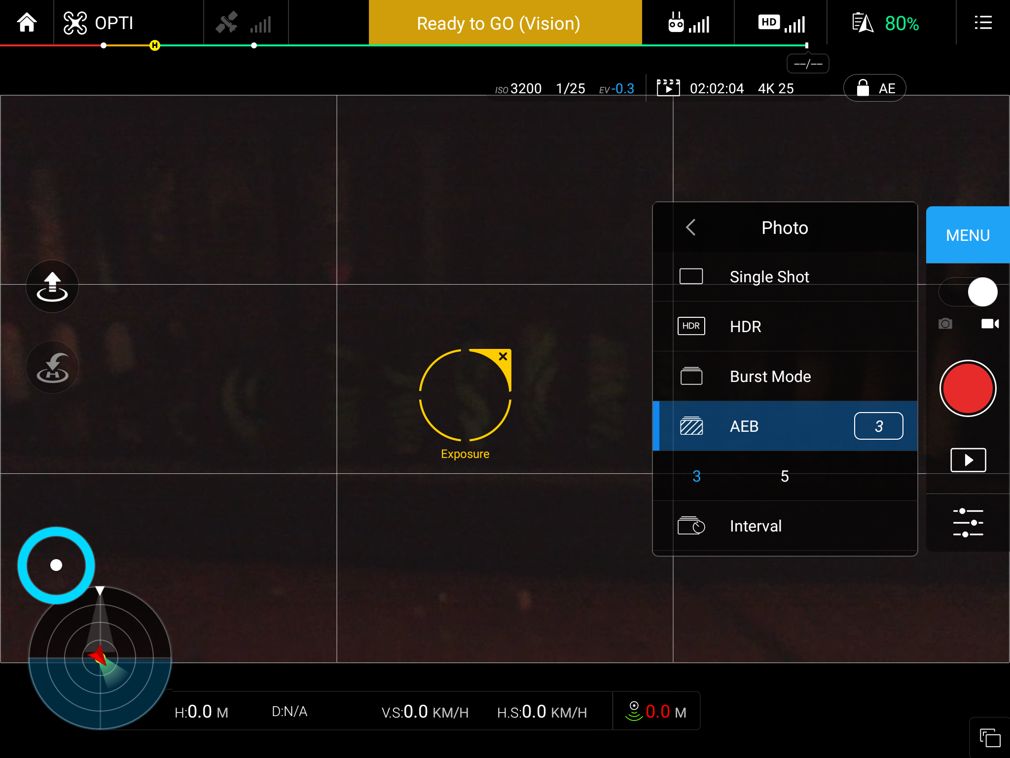

Looks like the camera was set to AEB shooting.
