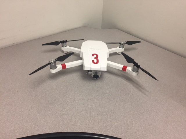

Today I flew my Phanvic for over 45 minutes, its first real test flight/ wring-out. I found it flew faster and was more responsive than a stock P3S. Endurance was cut down by about 2 to 3 minutes. I flew it with stock, graphite and finally with graphite folding props, all did well. With the stock props, it was noticeably quieter then a stock P3S. The battery heated up to 60C on the longer flights, the maximum you ever want your battery to get, the OAT was about 10C. It looks like this bird is good for short duration flights (just what I had planned for my bird) and is easily stored for travel. The only flight anomaly I found was when descending rapidly and then suddenly leveling off, the aircraft rolled to the left abruptly. I even got to to do a complete 360, this with the fold-able propellers. If you could solder well (or have access to someone who solders well) and have a little technical aptitude, this is a great mod to do to your P3, especially if yo have the dreaded stress cracks at the engine mounts.
I think I'm really going to like this!
4 questions
1. Are you saying your experiencing 2-3 minute shorter flights every flight ?
2. Is the battery getting this warm every flight ?
3. Due to construction of the battery bay - does it appear there is anyway to vent the battery a little more.
4. Is it possible the battery getting this warm is shorting the flight time ?
4 questions
Yes
Yes
It's possible, maybe with some louvers. Although the mod makes the drone more maneuverable and seemingly faster (I haven't totally pushed mine yet, got it up to 37 mph and it was still accelerating) it is heavier and probably drawing more power. I did install 4 brand new motors.
Yes
