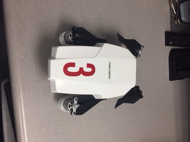

I just got my kit off Paul Wingfield, cheers Paul. I have browsing most of the build threads on YT etc, but they all seem to be with the P3Pro or Adv. My question is about antenna placement specifically to the Standard, does anyone have photos or solid advice on where to place them?
Just started the process of stripping down my P3S, this is where I am at presently.

Some more pics of my progress.
LED lenses fitted.
I had to sand down the lens for the front legs so there was clearance when the legs were folded.
