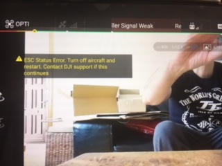

Hi everyone and apologies if my first post is a cry for help.
I bought my P3P second hand in December 2017. The seller is a genuine chap and hardly used the craft. I took it home and set it up trying out the simulator mode and the like. After this i stuck it in back the in the box with a view to using it once better weather arrived. A couple days ago i took it out the case and thats when it all kicked off. The first thing that happened was that i was asked to finish my DJI registration by providing a mainland China telephone number (a bit difficult as i am in Glasgow Scotland). After this i managed to get to the simulator screen and now everytime i try and take off i get this (see screenshot). Now i have been on the DJI forum and eventually received the secret (dont ask) firmware file. However i have either not installed the update correctly or the firmware fix does not fix it for me.
So in summary it worked in December it does not work now and i dont believe i have done anything wrong.
Any advice or guidance would be grealy appreciated.
Some other background info; I have already spoken with DJI UK call centre (not in the UK of course so language/accent issues but they were as much good as a trap door in a canoe.
Next stop i called the DJI recommended repair guys DJI repair doctors who had absolutely no clue as to what i was talking about. The assumed i had crashed it and wanted me to send to them to repair.
I now appear to be the proud owner of a £500 paper weight. Please can someone help me.
Thanks in advance Dario

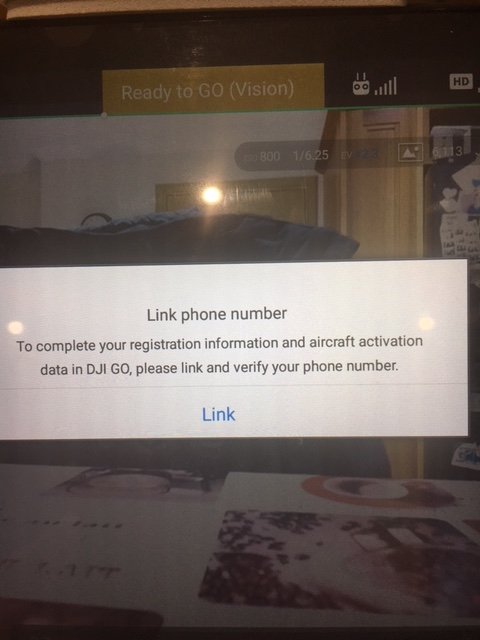

A total shot in the dark but the only reason I can think of as to why you might be asked to provide a Chinese phone number is that you might have accidentally enabled/or it just enabled itself?/ this setting. "Enable AMAP (for China Mainland)" As to the ESC status error message that you are now getting, sorry, I just don't know - it could be connected, but probably not.... But if you've been using the simulator a lot there is a chance that something has overheated but it's usually the gimbal. See here:- Standard - Flight simulator and you can find more info with a search (magnifying glass, top right)

What @Oso implied sounds very likely to me. Especially if you did not updated your firmware before the error appeared.
If you want to fix the issue by yourself, start by reading this:
ESC Error
Reactions: JoBe
ESC Error
Been there done that in that i have downloaded and installed secret firmware but still getting ESC error.

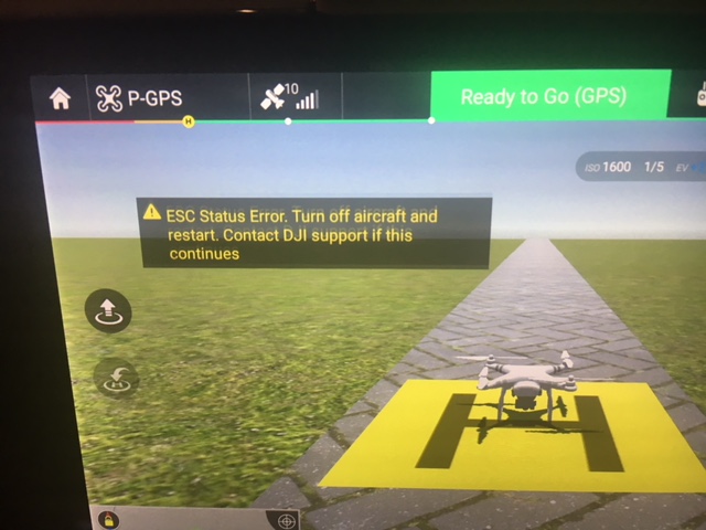

Two days ago i take the drone out its case and all this nonsense started. First it was enter the phone number to complete registration of your DJI account and then its the ESC error that you see on my screenshot. DJI have a firmware update that is not listed on their official web page but can be provide (if you ask often enough) by one of the administrators on the forum. For most people that have been affected by the ESC error this clears the problem but unfortunately not for me. I think the best option now is to get the drone into a repair shop.

Hi Dario ... I'm still confused. I understand what you write - but cannot understand why a Chinese number if you have already created account etc. (You did say a Chinese number asked for originally).

You're confused ! I understand its really weird but that is what happened re the phone number. Again if you check with the DJI forum you will see a couple of threads about the same thing. Thanks again for trying to help :-D

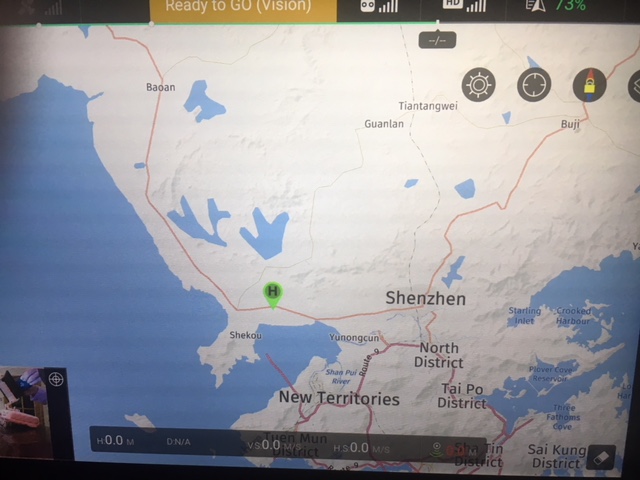

I think i have read somewhere that the DJI go app request for a mainland China phone number is related in some way at to where the drone believes it is (if that makes sense). Again i am a little unsure because i have been trailing so many threads but i think the theory is that that there are restriction placed on your ability to fly the drone in China without suppling a phone number. Now i have checked the map setting and both are switched off. When i tried the drone again in simulator mode a moment ago the home point was set as somewhere in China (see screenshot). I did take the drone outside so that it could connect to GPS and so set the correct home point. However when i tried the simulator mode i got the same ESC warning and i was unable to start the motors.

What happens when you try to power up and 'fly' outside ? I'm not saying take-off .... but power up and do all just short of actually taking off ?

Still no further forward with this. I am still convinced it is a software issue rather than a fault with the drone. Had online chat with DJI support today who suggested deleting the DJI Go app. Also advised to search for all other DJI cache files and remove. Then to reinstall app log in and switch off China tab. Did this but still does not work. See screenshots of various
Getting to the point of wanting to chuck the feckin thing out a window
