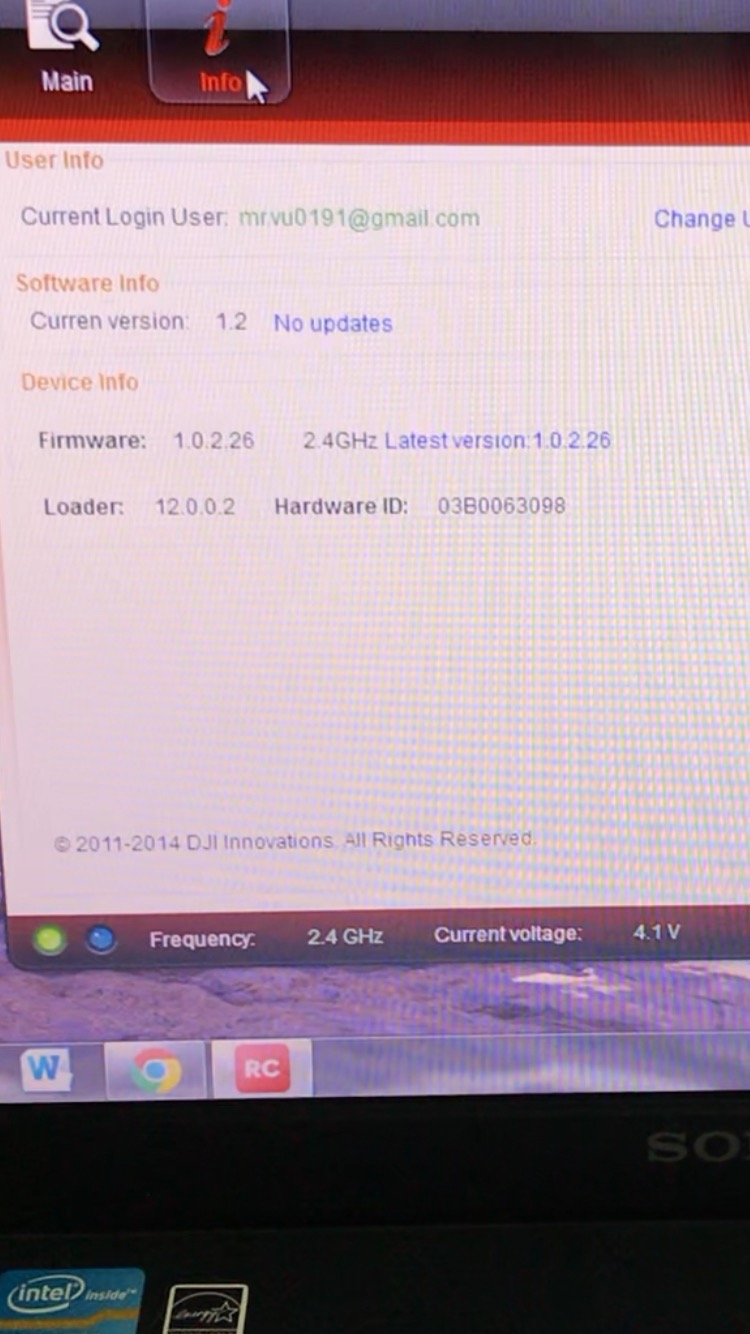

I have tried connecting to the controller assistant.

I researched more on youtube.com and found that many people face the same problem but still can't fix the error.
I calibrated the controller via the RC sytem software on the computer and everything is fine.
Calibrate P2 via PT2 V3.8 + RC software (re-calibrate).
I'm not sure what I'm missing.

the controller is bound as the lights go from fast flash to slow flash, have you tried an IMU calibration in the software, also not sure if im reading your post right but controller calibration is done first in the RC software then again in the phantom 2 software, the first stage calibrates the sticks to the controller then the second time calibrates the sticks to the IMU in the quad.
I make sure the controller calibration is done first in rc software, then again in phantom 2 software. I will try recalibrating the IMU. Thanks for your comments.
