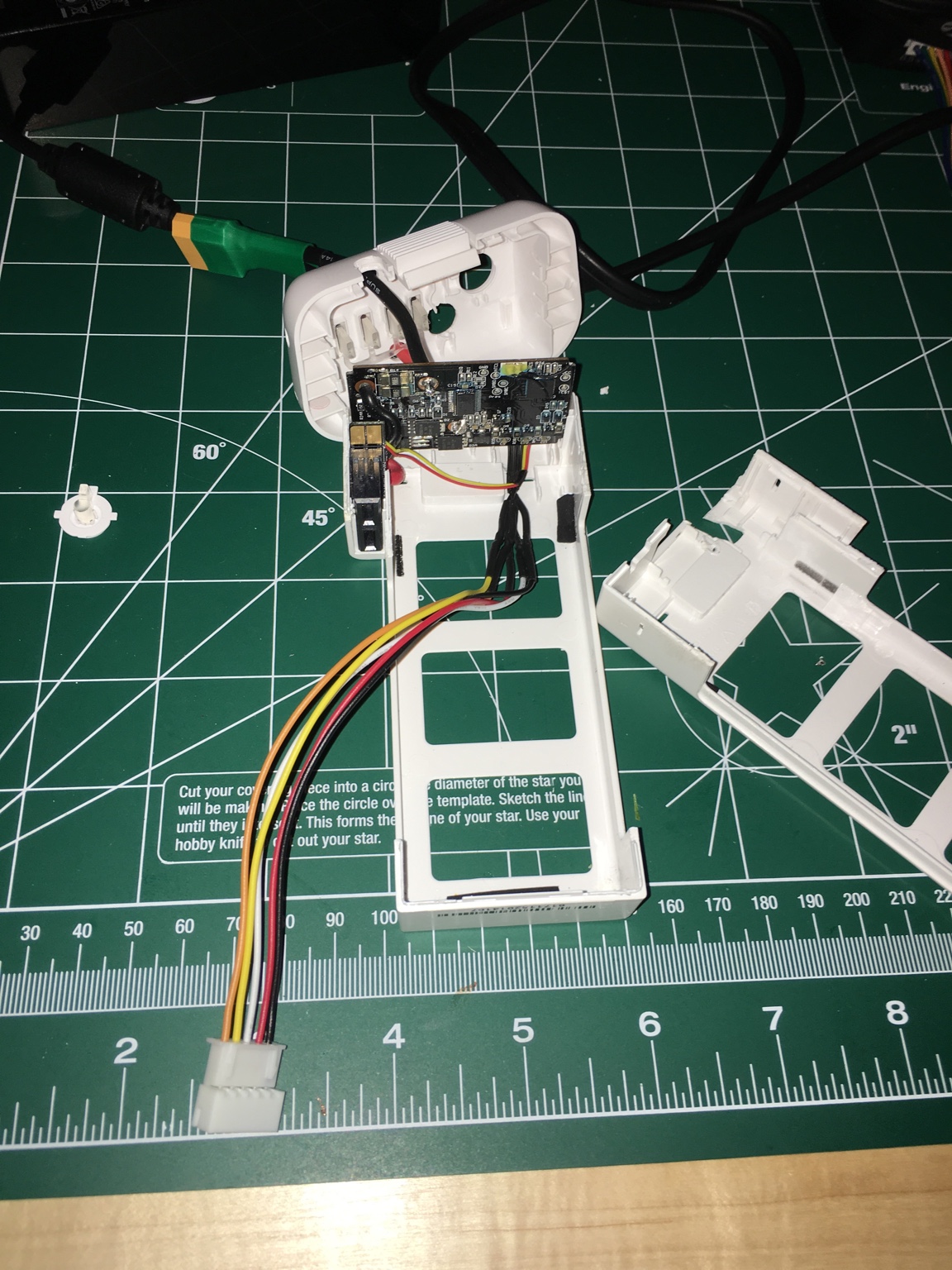

Maxwell. I happened to be watching this video again and I'm wondering if your DJI smart board hooked into the multistar 6600 displays proper mAh/voltage in DJI go? It is my understanding that the smart board has a lot of programming and I'm not sure if it will recognize the extra mAh. Do you charge it with the DJI charger? i.e. Through the smart board or with a different lipo charger? I believe there is a delicate system in which the smart board remembers how much mAh was put back in and that's how it knows how much mAh and % is left when you're flying.
I'd be interested is knowing if you've measured the battery with a meter before and after flights to see if DJI GO is reporting accurately. I've made up a similar board but have not tested it yet. Maybe this week.

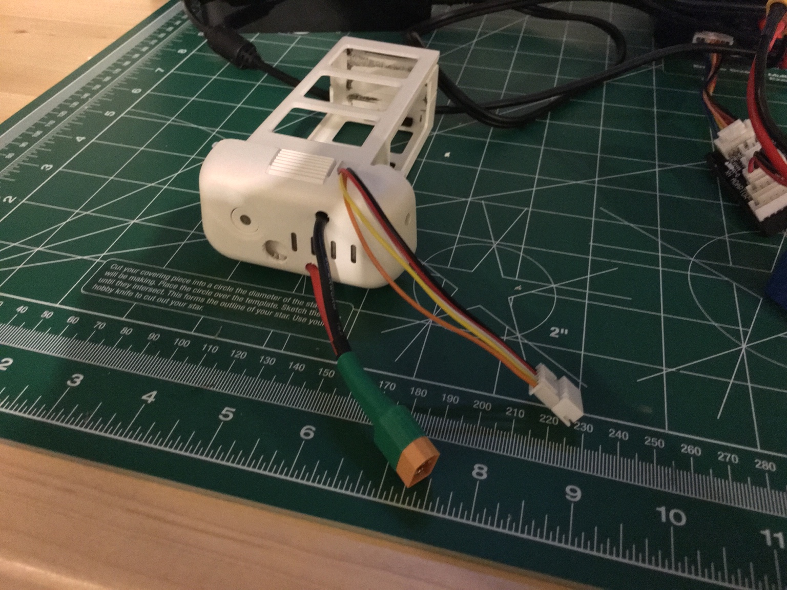

It's sloppy right now but if it works I'll neaten it up. I know I read about this months ago and if I remember correctly, the people abandoned it due to the issues I mentioned above. But I am off this week so have time to tinker and see for myself.
