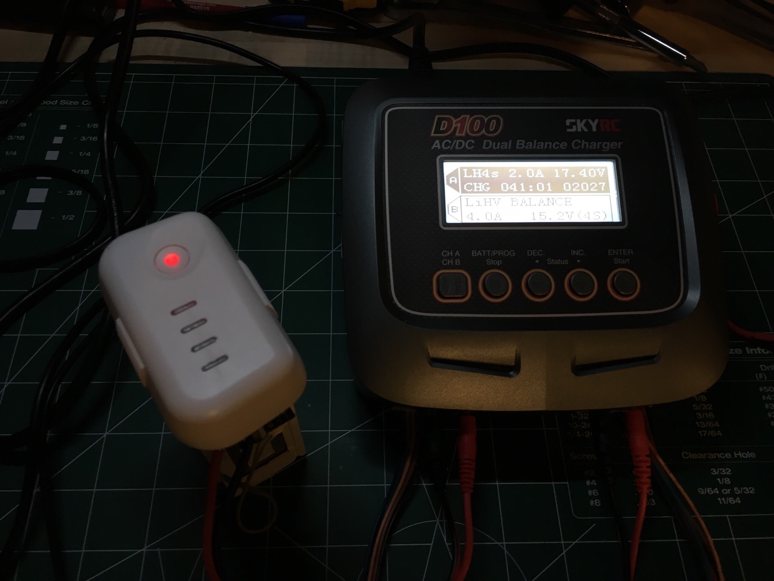

That's what I did with the first 2 batteries I tried. I noticed my lipo charger doesn't pump 17.5v when I tried to top them off.
I popped this 3rd bat on at 50% and I watched it ramp up voltage but never got up to 17.5v. Right now sitting at 16.87v and 88%. It's creeping up though...
Reactions: Digdat0
Almost done. Stepping down amperage and voltage holding at 17.4v.
I think I confused you by not explaining it right.
The 17.49v output I measured was at the banana plugs while the battery is charging. I only plugged them in halfway so enough was exposed to measure the charging output voltage of the lipo charger.
Really I'm mostly concerned that my battery isn't fully charged with the dji charger. Simply turning the battery on after the lights go out will jump it back into charge on the dji charger? I guess I can do that at least, in the mean time.
Ok so it finished. Measured with my meter and reads 17.30v.
Here's what Go says...
@Ed209 I see your charger puts out 17.36v while charging. I bet if it put out 17.49v it would top the battery up even higher.
