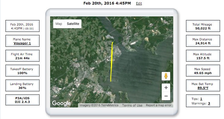

Still breaking in batteries but flew out 4.71mi. I know not nothing near record but was just wanting to push the bird farther after 9 flights on new mod. FPVLR v2 Boosted and G6 1800s run nice. Next to compare the 2400s. On this flight was flying into the wind with 20-24mph max speed. Return was going 40-49mph. Very impressed. View attachment 44544
