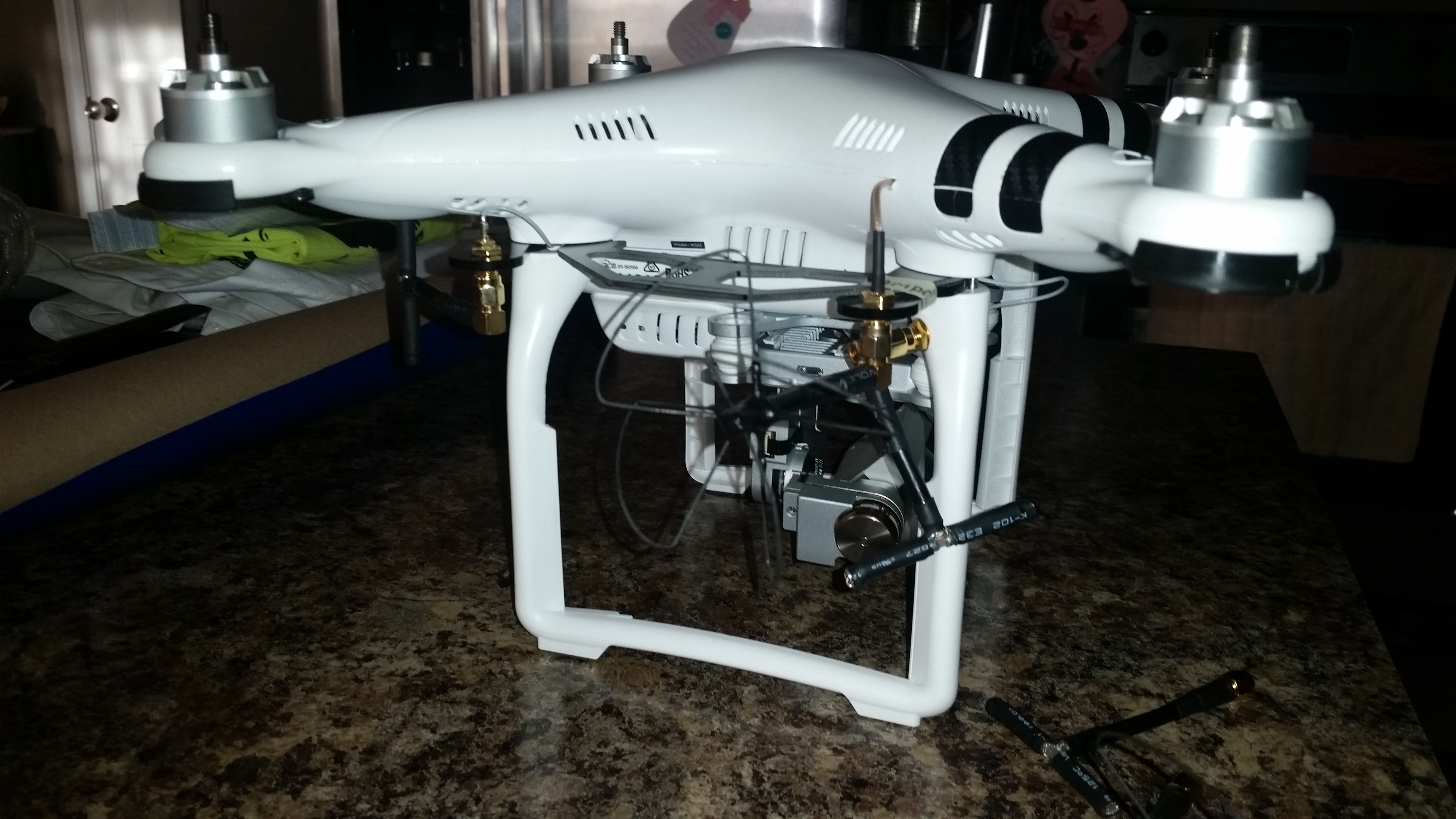

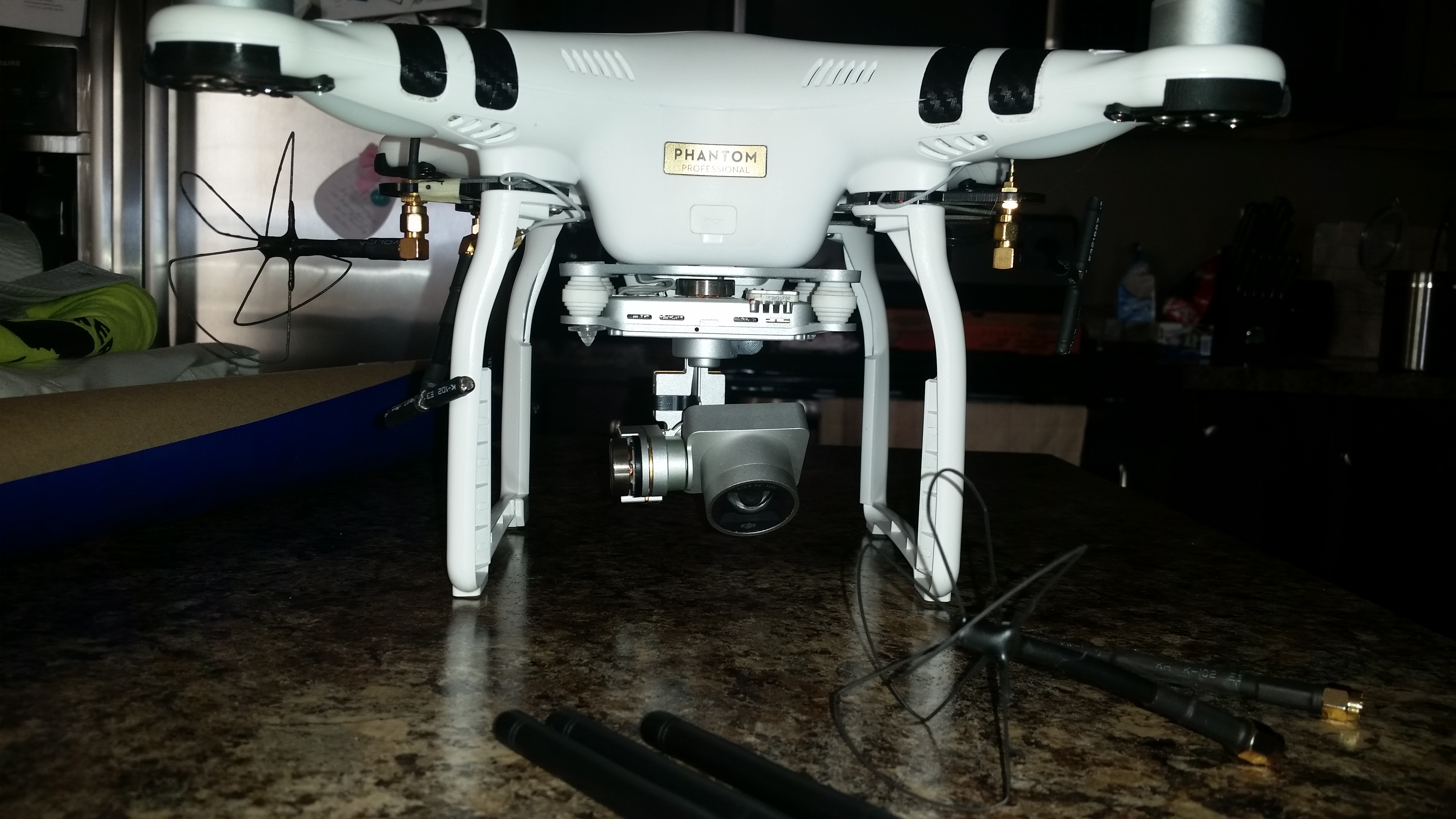

If you get some good light that camera may take better photos
Yeah, i'd be concerned with the shadow also because we are doing this for long-distance. And it looks like you have two video antennas on the same side of the bird at some point either coming or going that's going to cause a problem ,maybe negligible, but from what I understand you're trying to go past your 4 miles that you was going without the mod!
It's ideal to have one video on front corner one on back corner but opposite sides, and same with control
That's exactly what Tony told me. I'm wondering if just swapping the birdside internal antenna connections on the 4 stock antennas to create this diagonal configuration might be the simplest and best solution for both video and control at long range...
