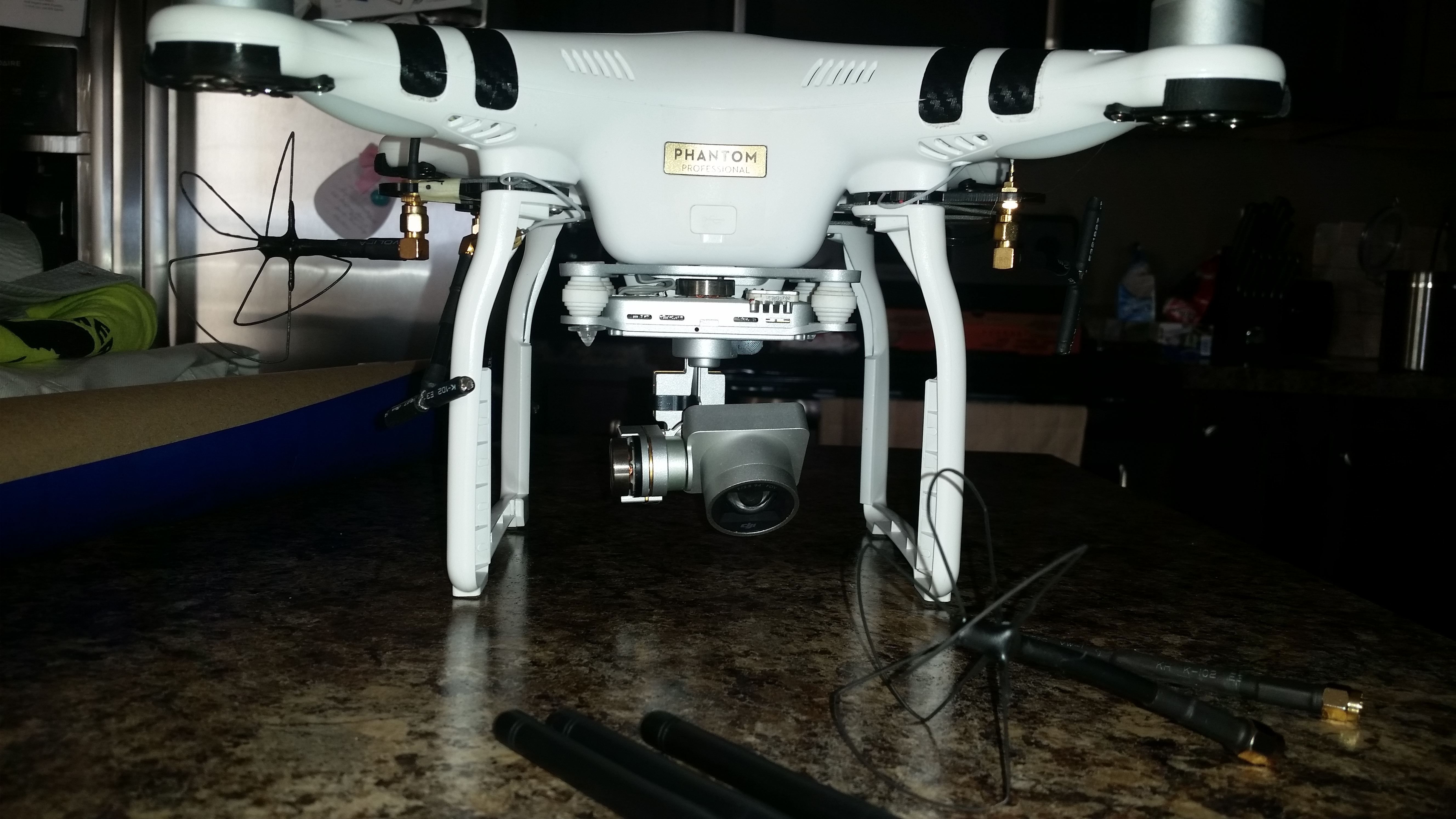

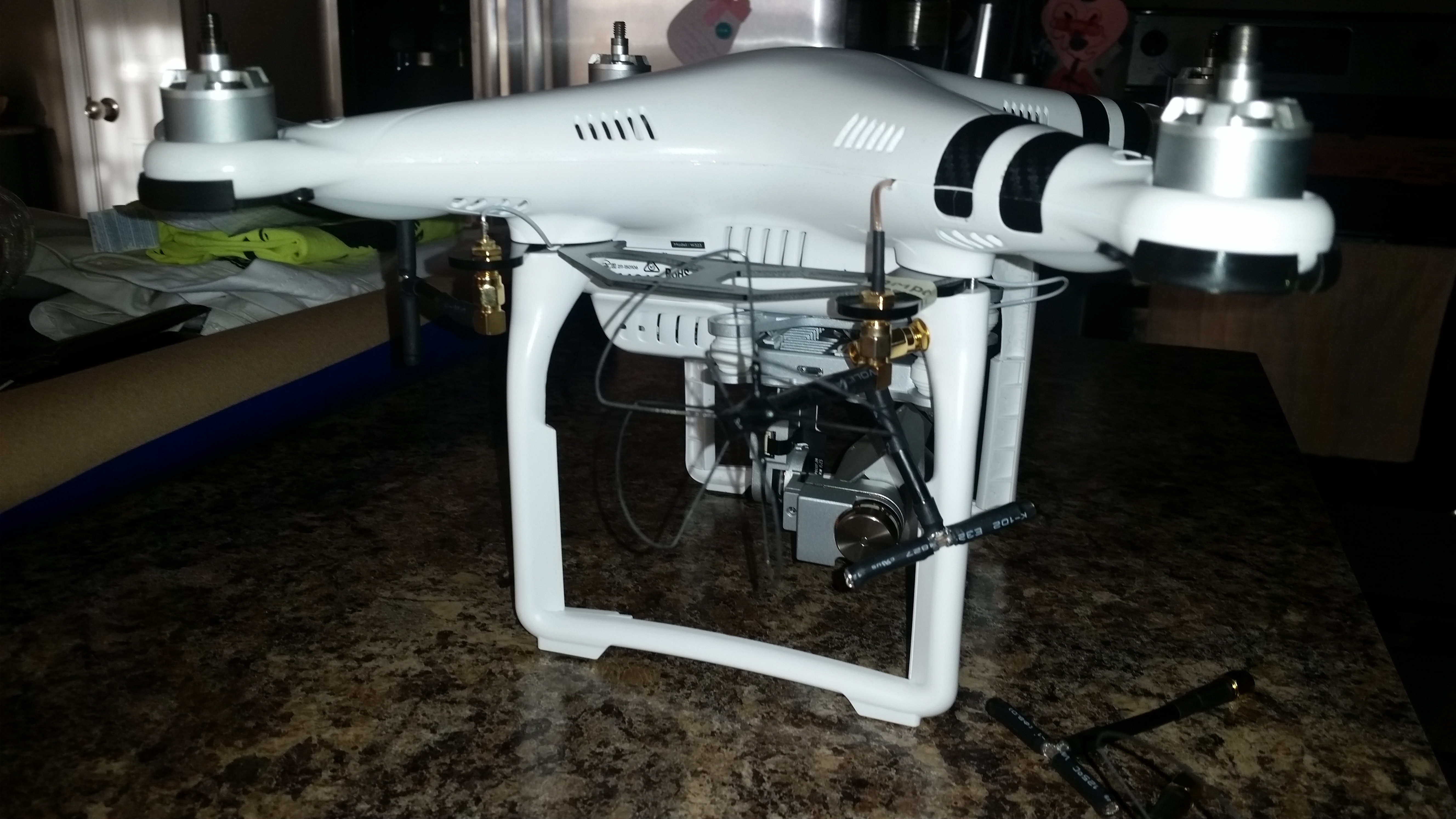

Hey guys I really need some help . I got my bird back from tony and now the amp is on the correct antenna but now all four of my stich antennas have been replaced with sma connections. I'm trying to figure which type and orientation will get the best results . Thank you in advance!
First thing I would do is replace the control antennas back to the stock units! 2.4 control antennas on the phantom three and phantom two don't have much room for improvement. If you're using the itelite panel you can try Tony's dipole. That's a good combo I don't think it's going to be better than the stock antennas though for control.
Believe me nobody's more obsessed with distance, battery life and long-range flying than I am, but I will be staying away from the bird side amp
Reactions: Silverwingflinx
Hey 13, the dipole in yer pic is not positioned correctly. Dipoles should run straight out from body with the top or T section of dipole running from feet to topshell( if that make sense) they shouldnt be angled down at all but no more than 30% .
Also it would be wise if you could get dipoles and pinwheels caticorner to each other one on each leg bracket instead of (2) on one leg.
Yeah, you got a hot mess goin there. I assume you have no Birdside booster now?message me your results
Yeah definitely a mess and not what I wanted. I had tony move the amp to the inside of the bird. When I sent my bird the first time tony told me he could keep all the stock antennas on the bird but he then told me it would be best to replace 2 of the stock antennas. But my bird ended up with three non stock antennas when I got it back. Then he put the amp on the wrong antenna so I sent it back a second time and now it came back with all 4 stock antennas replaced. I wish I had never messed with it. It's been too windy to test it out yet with the amp on the correct antenna. So the dipoles should be horizontal with the ground ?
