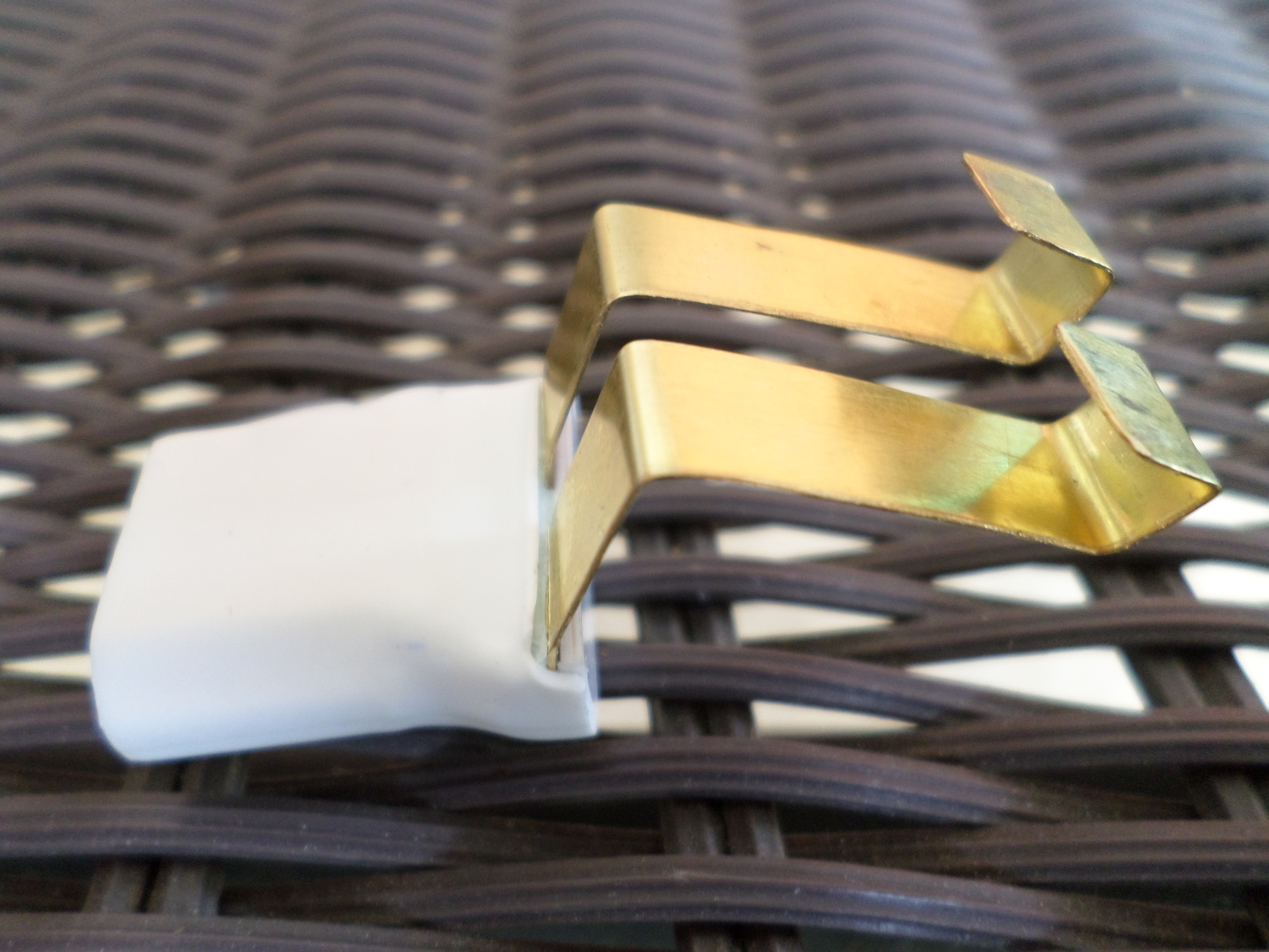

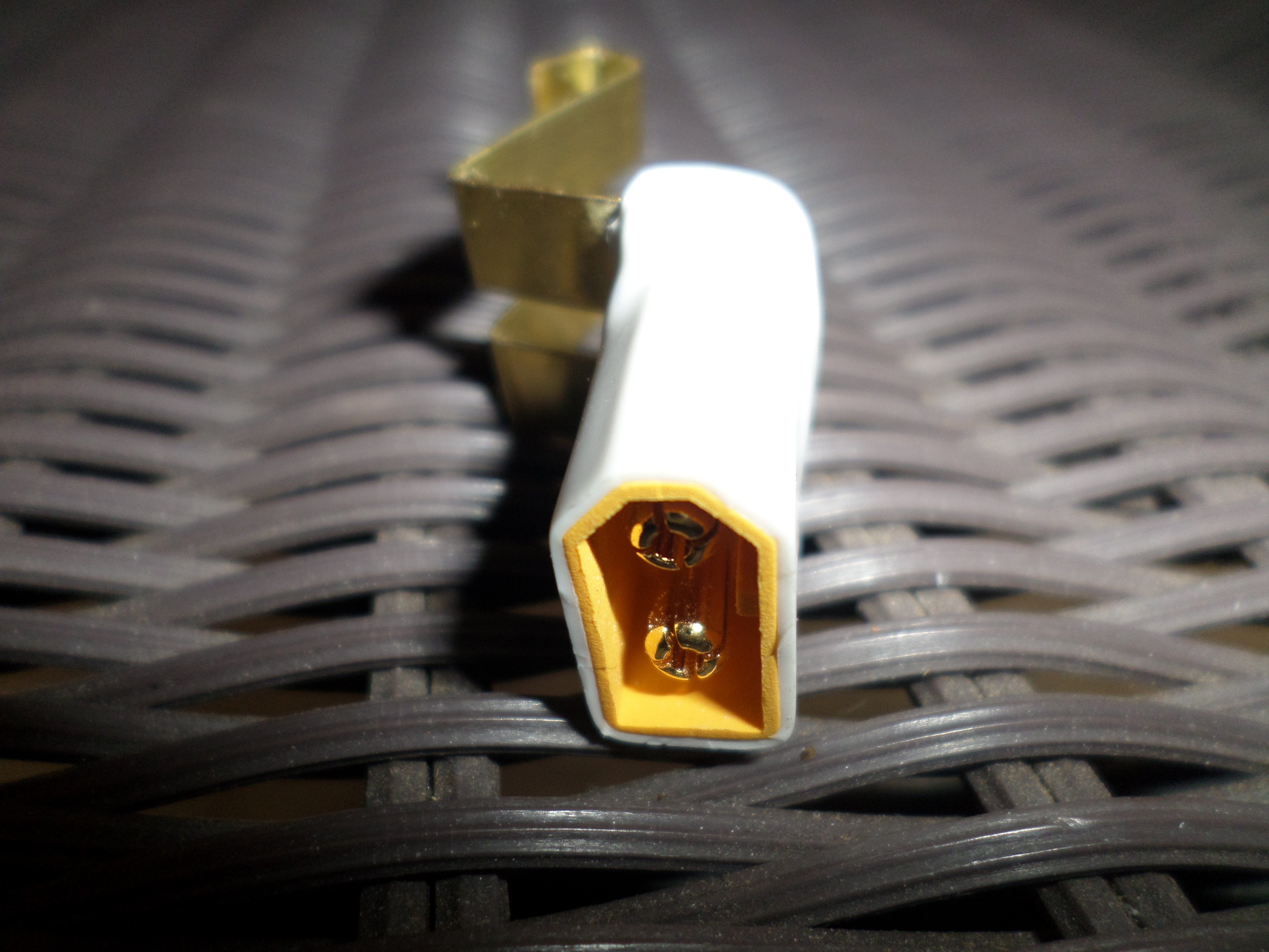

Look at the 2 links in post 1455 below which should answer a lot of your questions. The easiest mod is power clip since you can use it with any batteries. Make your own for $10 or buy one for $45.
http://www.phantompilots.com/index.php?posts/1046085/
Where can I buy it for 45$? And how do I make it? If I could buy it easily I may do that.. But if building it was a real easy task with objects I have or can buy easily then I will do that instead. Is there a step by step anywhere that shows you how to make these? My biggest question is what are they using to make the pins/tabs.. Some type of thin metal? If I can just go to a hardware store to pick up what I need to build it I'll prolly just do that .. The clips seems to be the easiest rout for the battery mod. This way I won't have to worry about ruining any of my original battery's. And can use the mod with any of them instead of having to mod every single one of them.

Here are the links to some of the stuff you asked.
28 gauge copper sheet - https://www.amazon.com/dp/B00IX43HGE/ref=cm_sw_r_sms_c_api_EOQCyb989ES4N
XT60 connectors - https://www.amazon.com/dp/B01ETROGP4/ref=cm_sw_r_sms_c_api_IcRCybJ6GPRTN
14 gauge wire to make XT60 extension cable - https://www.amazon.com/dp/B00UR0N370/ref=cm_sw_r_sms_c_api_ceRCybDA6D924
Battery wings - DJI Phantom 3 Battery Wings
Battery clip - DJI Phantom 3 Battery Clip

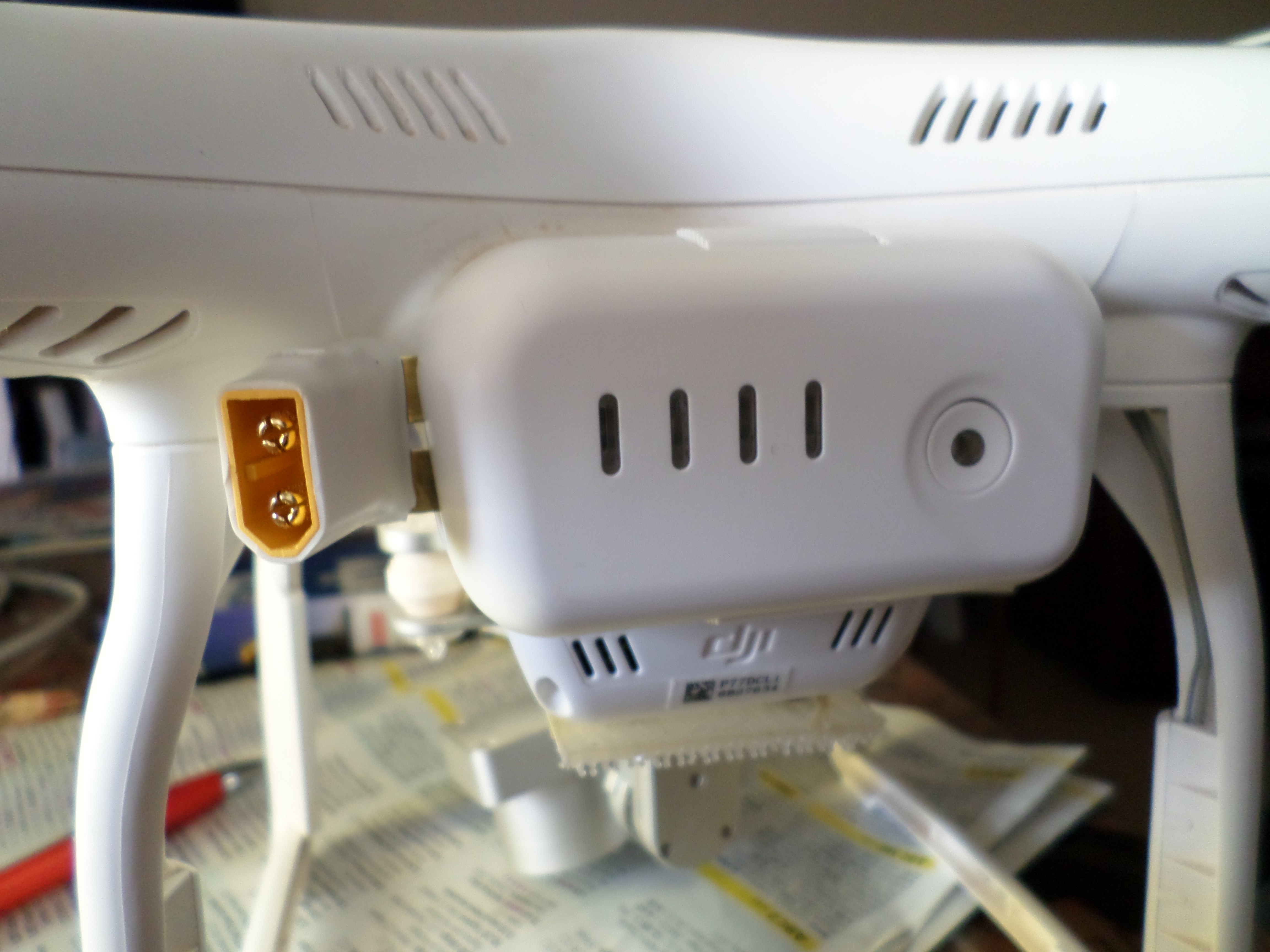

Hi my P3P battery adaptor arrived today, hopefully should work a treat. It can take up to a 6600 mah external battery. The forecast looks good for Saturday so that's when I be flying next..cheers.SAM_0529.JPG SAM_0529.JPG SAM_0530.JPG SAM_0533.JPG
