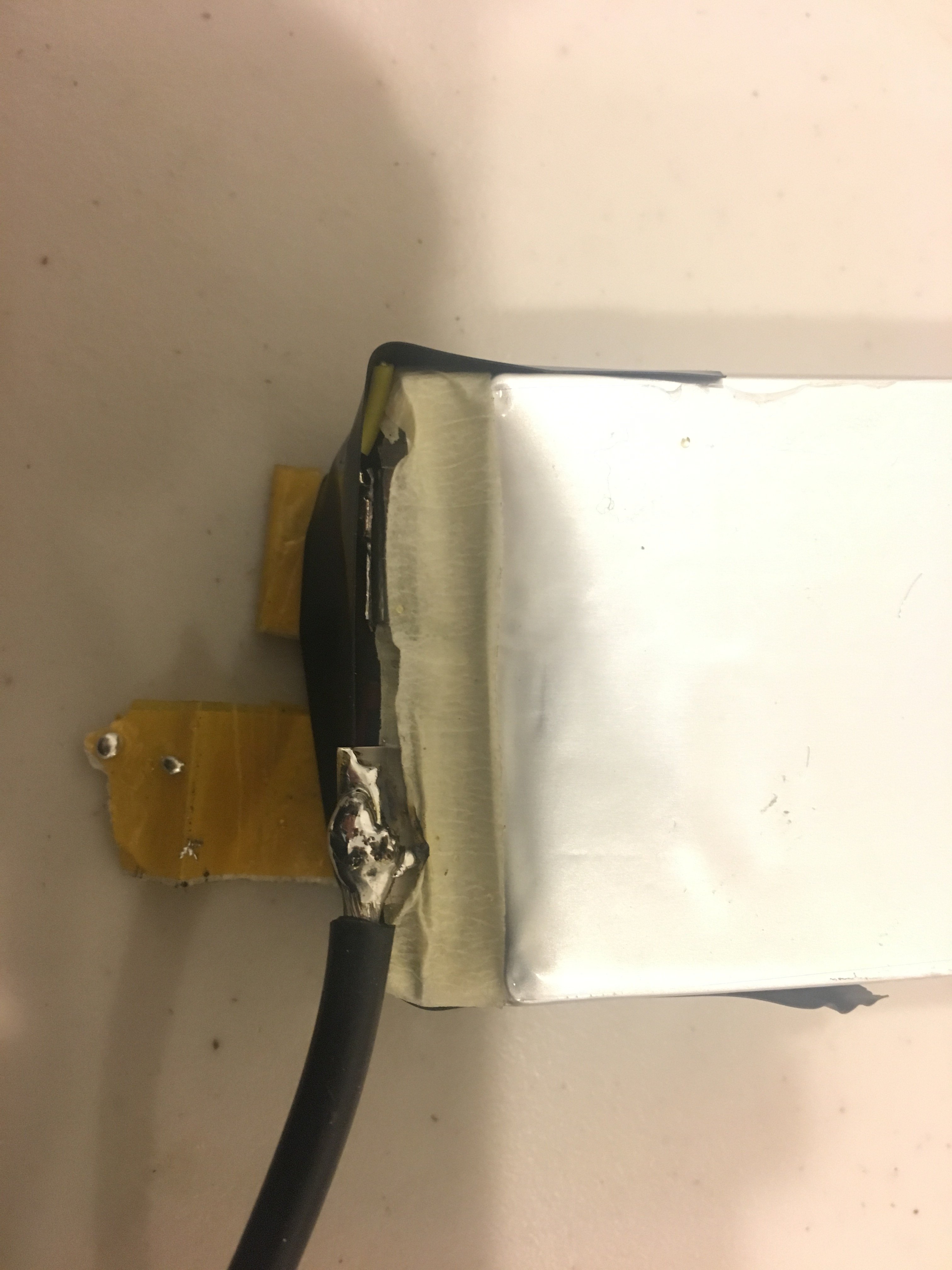

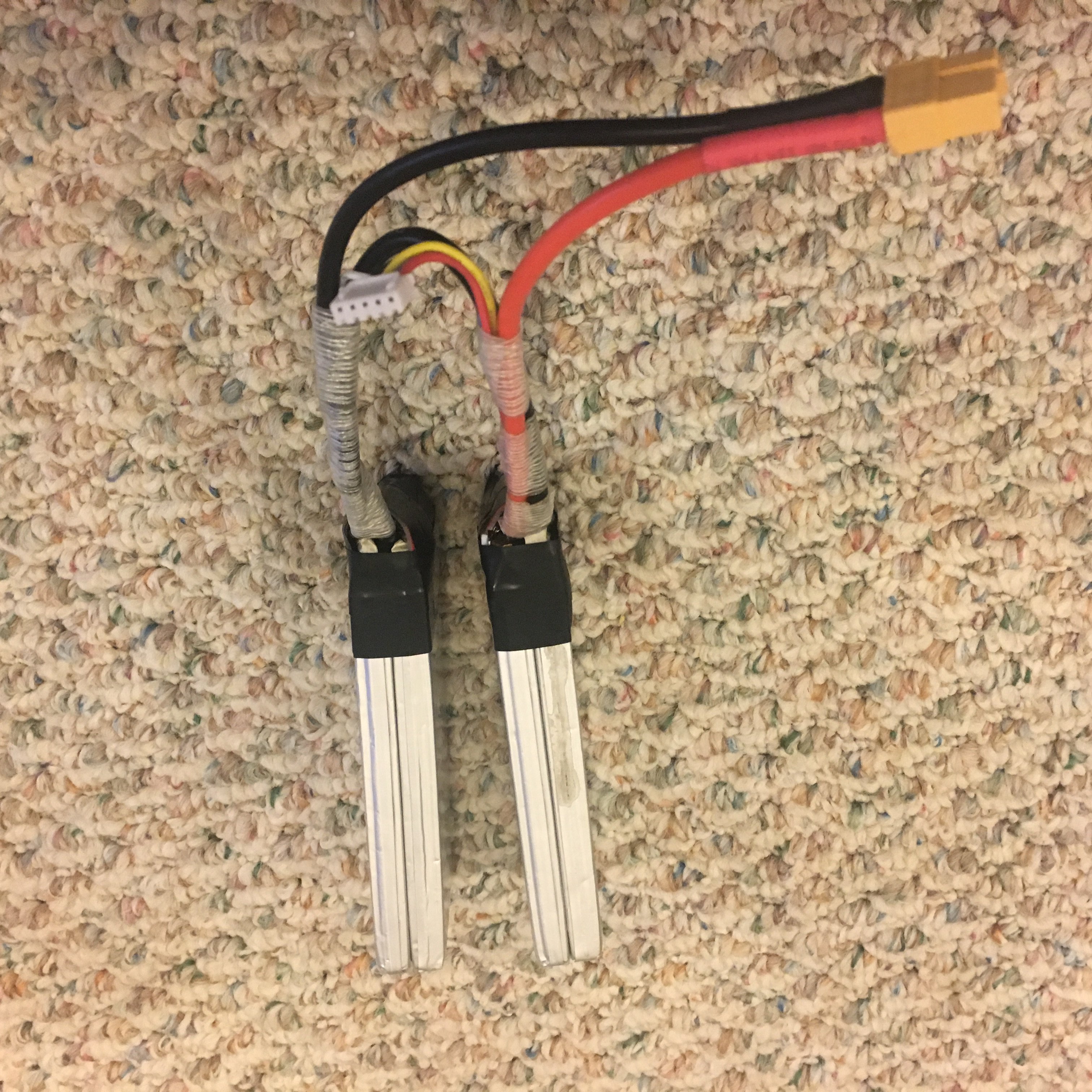

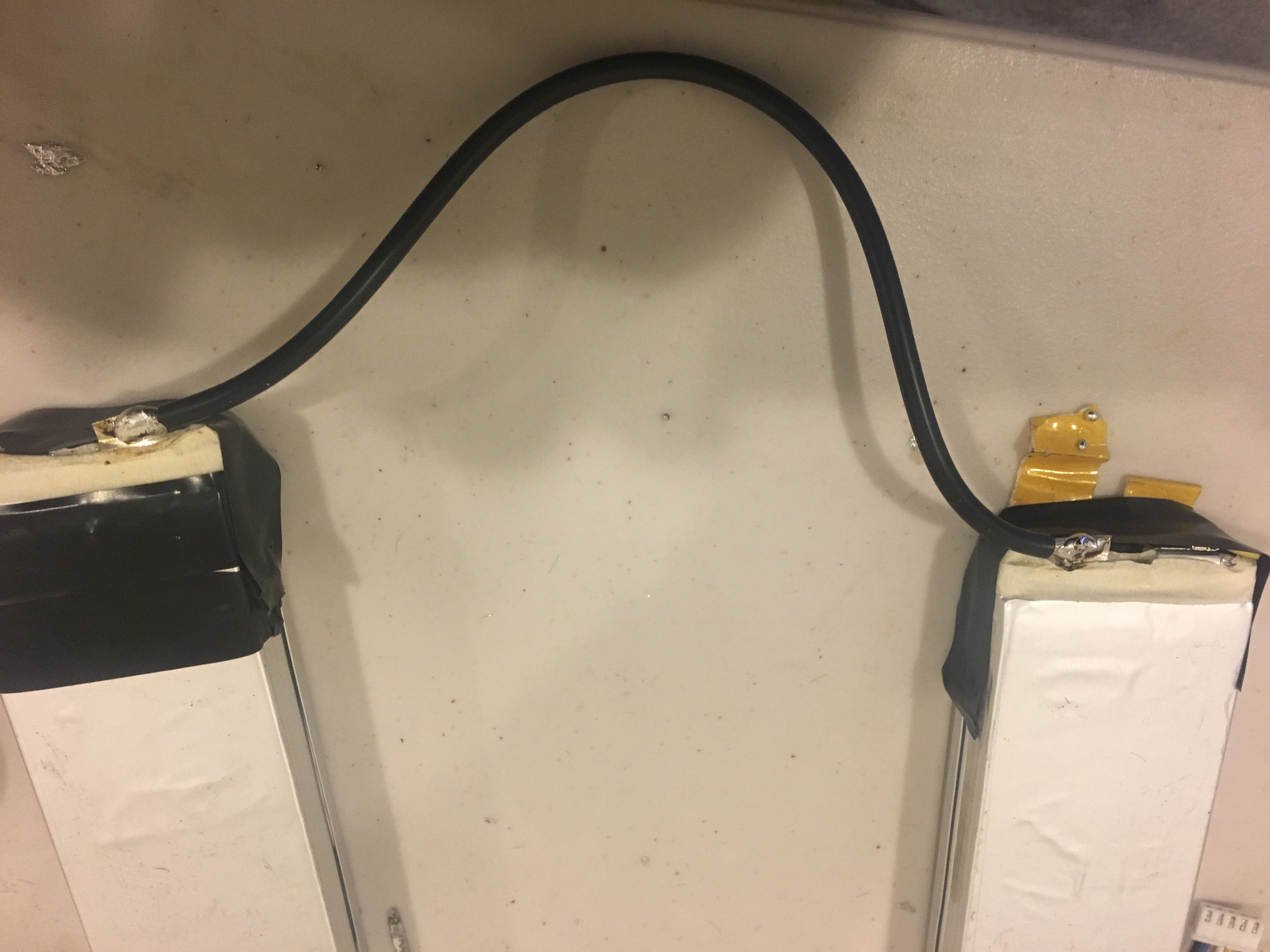

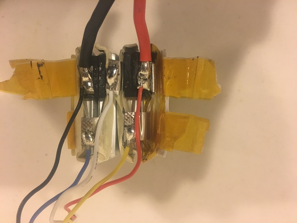

With instruction from Procharged97 I split my MS8 battery...Thanks PRO...It wasn't too bad...The shrink tube I got was too heavy and not good for this application IMO...I ordered different tube- 80mm flat - 50mm diameter from E bay and I hope its a little thinner...I ended up having to add aprox 50mm to the balance leads that were originally 150mm long when I purchased them...The fist pic is what I saw when I opened it up...The last pic is an almost finished split battery...Hopefully she don't crash and burn next flight :)View attachment 70031 View attachment 70032 View attachment 70033 View attachment 70034 View attachment 70035
Looks real good Chazz!!! 80mm shrink is the way to go!!

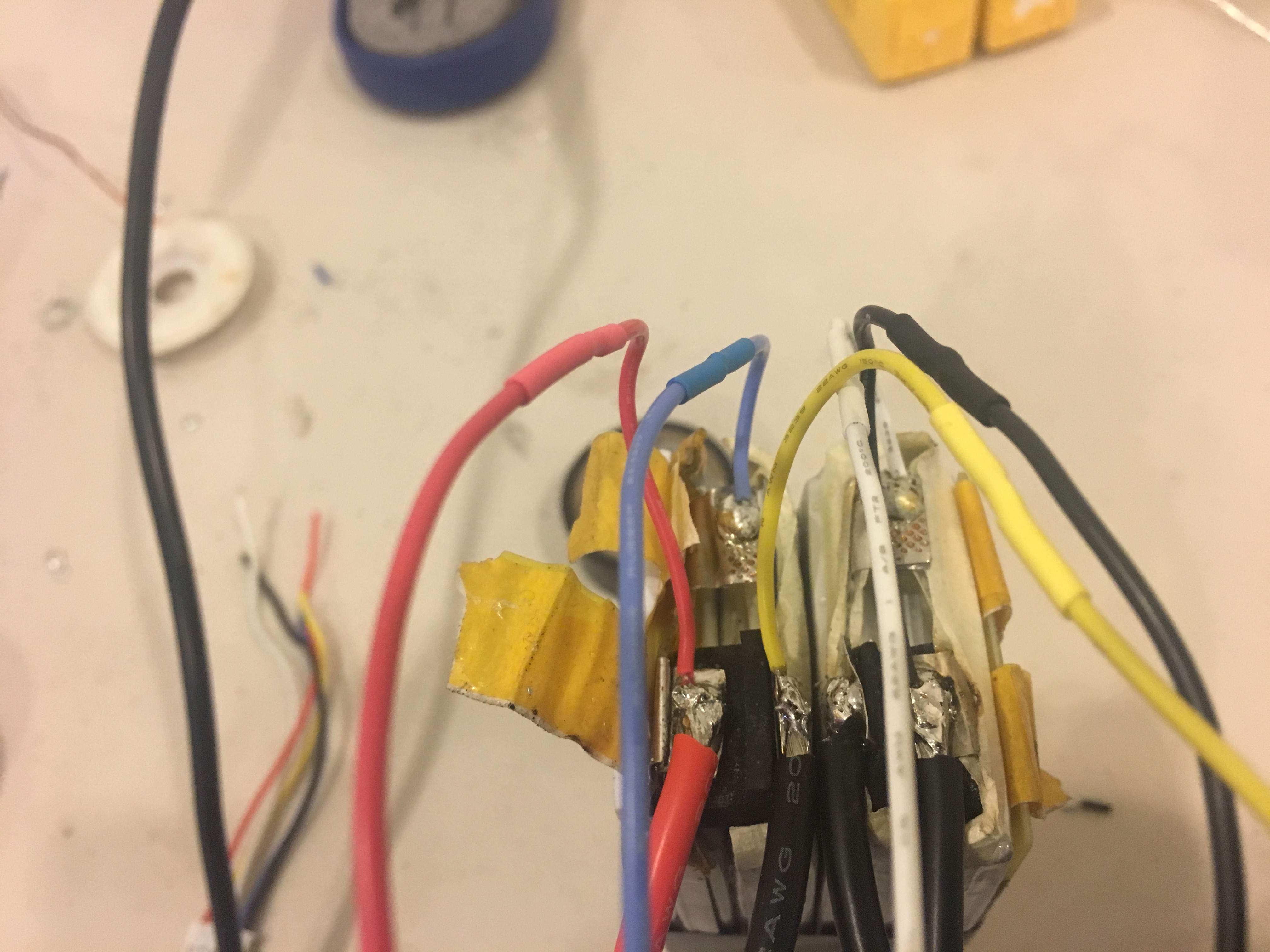

Did the battery split on the MS 4000mah lihv but might need to shorten my balance lead as i made it to long..went out for a quick test which was mostly hover and was fairly windy today... landed at 15% with 28min 23sec flight time.
final weight after split was 352g

Good job on the split. I guess time is expected to be lower than a single. But hopefully you'll get better time with calm or no winds. Is the wiring correct for split batteries? Any pointers?
