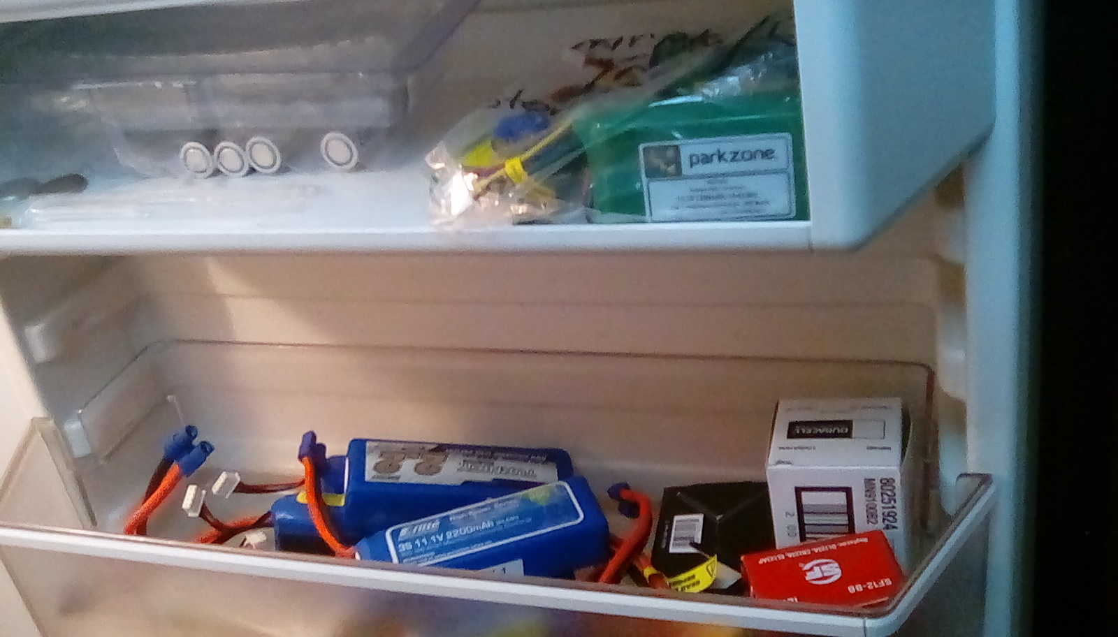

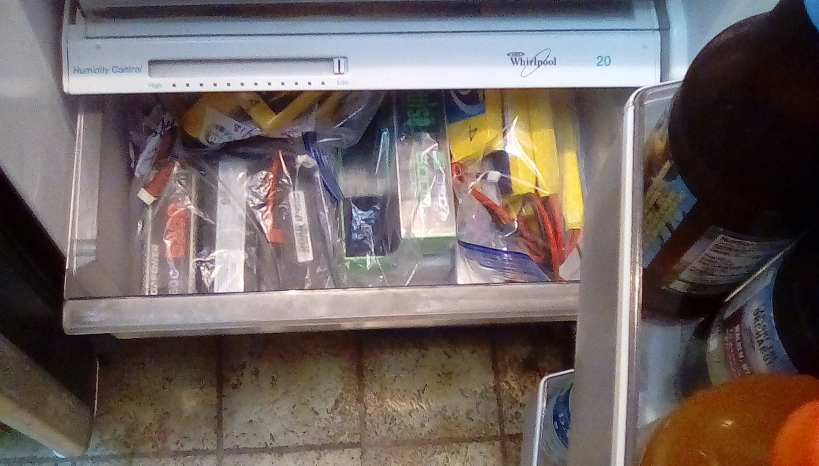

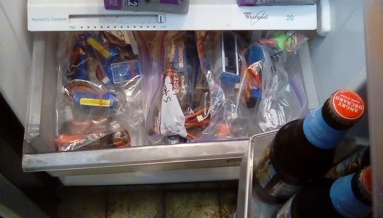

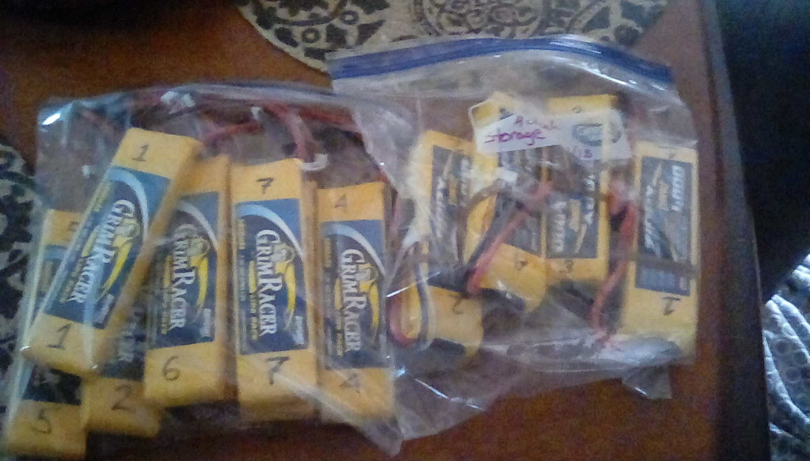

Also for some of you guys that are unsure how to store lipos, store them in the refrigerator.
Balance with a storage charge and they will stay fresh for years. Some of mine haven't been used in 6-7 years and voltage stays at original storage charge. IR is perfect as cold will stop most chemical processes. I'm new to multirotors but been flying heli's for 6 years, cars and boats for 20 years non-stop.
