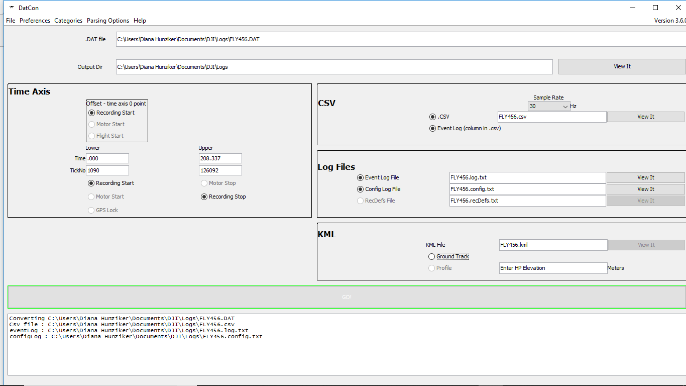

So how do I view these? Thanks for the help.
1. Use the Excell plot package to look at the .csv
2. Use CsvView (obtain here). The .DAT can be submitted directly to CsvView
BTW, the .DAT shown, FLY456, isn't actually a flight. There was no motorStart. Look here to see how to pick the right .DAT

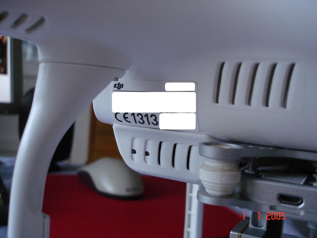

Take a look on the attached pic. Would you please note what FCC number has your AC ?
The same what FCC number has the RC (see on its bottom label).
