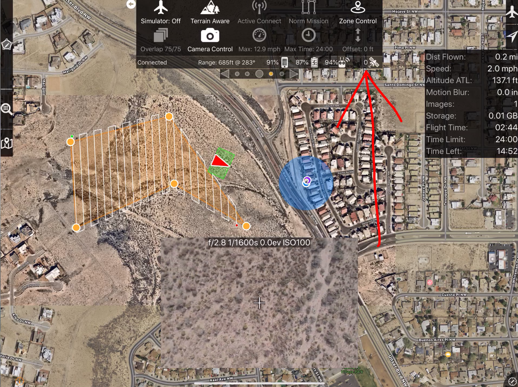

So this post got me to thinking that MAYBE my Vision Positioning sensors are getting worn or have been damaged (no hard landings so far). So today I disabled VP (which automatically disables PL) and conducted some test flights. Same result...argh. But I noticed that my satellite acquisition was ZERO. What?!?! And sure enough, the P4P drifts around like she's in ATTI mode.
So I tried the test mission a few more times with inconsistent results. Sometimes she would fly just fine, but about half the time would LOSE ALL satellites for just a split second, which would end the mission. OR...she would lose them and never re-acquire them.

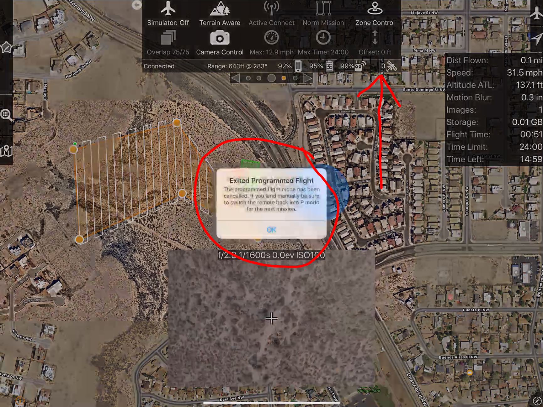

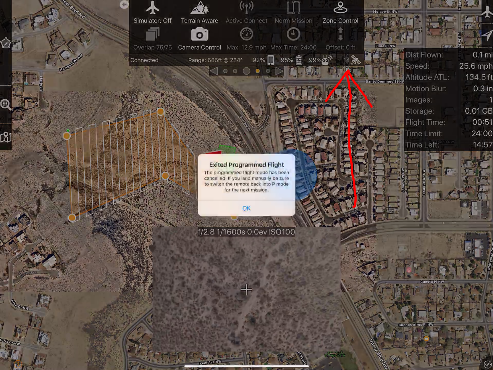

You can see in this screen capture that I lose all 15 satellites for just a split second:
Naturally, this causes the mission to end abruptly:

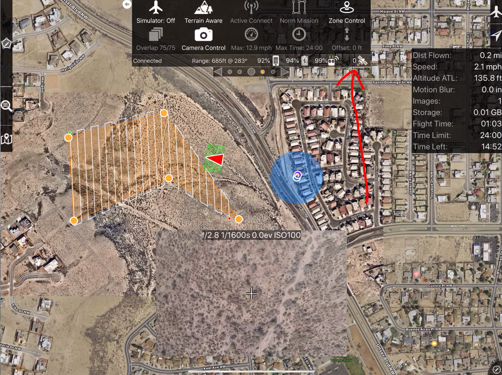

But then, after the missions ends, I get my satellites back:
But then, after a few seconds, I lost all satellites AGAIN. This time the loss was persistent. The canary in the cave is that she drifts as if in ATTI mode. It wasn't very windy today, so drift was very slow.
So I turned the bird around and started to fly home with zero satellites:

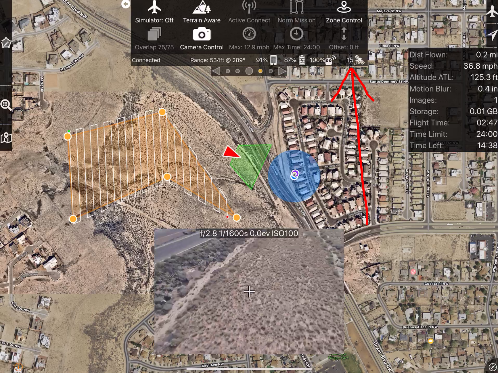

But then, out of nowhere, I got my satellites back:

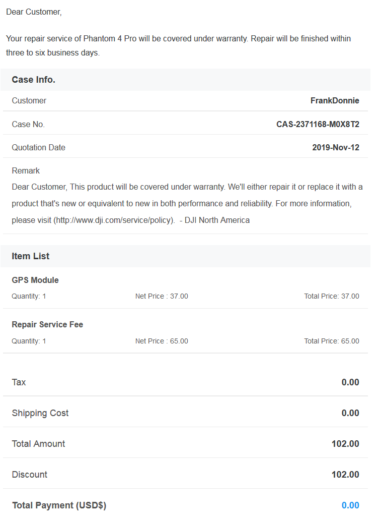

I'm going to guess a failing Satellite Rx board. This drone has suffered no shock, so I assume it's a failing board and not cracked antennae or bad connections.
In checking my records, the drone is still under extended warranty. So I'm just going to send it in. We have a mapping job tomorrow. My partner has TWO P4P's that I already modified to be exactly like my P4P (same firmware and hacks). So we're just going to use those while my P4P is in transit. I just boxed it up and am sending it out tomorrow. If the issue is not covered under the extended warranty, I have Care Refresh until the 29th of this month. I'm tempted to pay the $119 and get the replacement drone, but I don't believe they send new ones. They send them reconditioned. And Lord knows what that means to DJI. At least I KNOW my drone has been well taken care of. We'll see how this pans out.

Yep. But I was 95% sure it was either the module, the GPS puck antenna OR a cable connecting the two...all simple fixes, but as we're all well aware, cracking open our drones voids the warranty.
