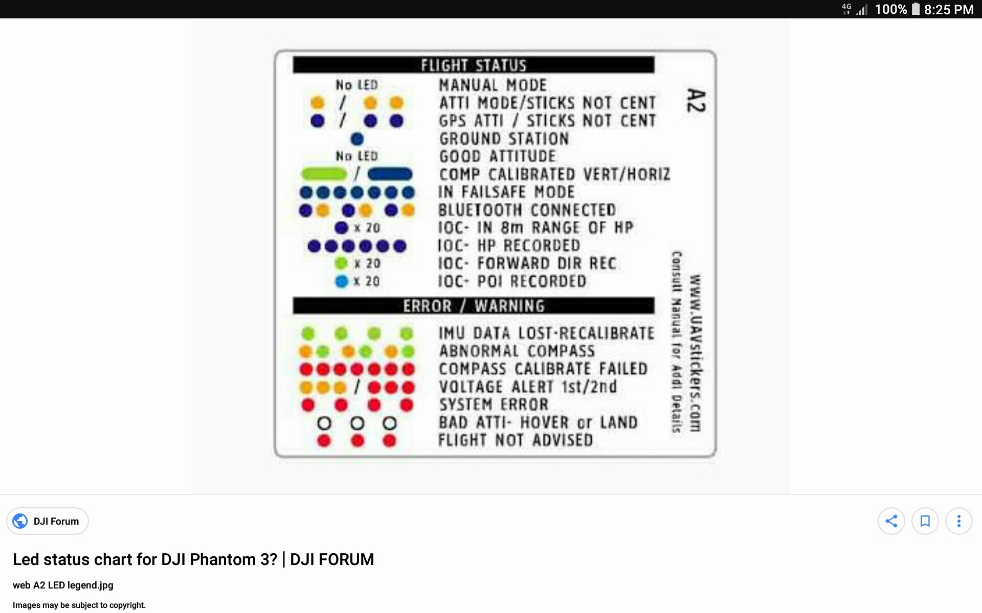

Here's a light chart,try turn wifi on last,if don't change delete and reinstall app

Here's a light chart,try turn wifi on last,if don't change delete and reinstall appView attachment 104399
None of those error light match my aircraft. It beeps 8 times flashes yellow light at the back and solid red at front after 8 beeps its one flash of all light and cycle repeats.
