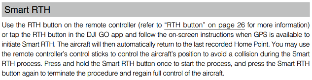

So this means that even after moving any of the sticks, the RTH would continue?
Correct. When using Smart RTH, you must cancel RTH by pressing the RTH button on the remote controller or cancel it from within DJI GO.
Per the Phantom manual:
