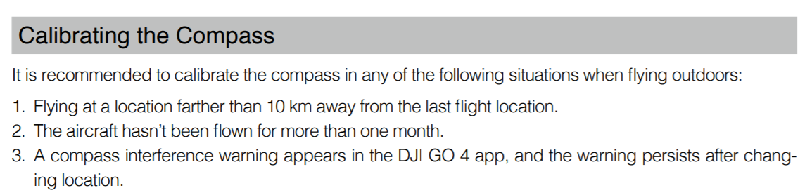

The OP is asking about the Mavic, not a Phantom (albeit, in the incorrect form).
Here is what DJI actually recommends for the Mavic:
#1 (the first thing they recommend)... calibrate when flying at a location further than 10km away from the last flight.
DJI's manuals unfortunately are not always up to the standards of their hardware, and have a long history of randomly including mis-statements. This is one of them. There was never any basis for the "recalibrate if you change location" advice, which is why, presumably, it was removed from other product manuals. In any case, it is pointless advice since the purpose of the calibration is to subtract out the magnetic field of the aircraft, which should not change with location unless it becomes magnetized on the journey. It has nothing to do with the characteristics of the earth's magnetic field - that does vary with location but the aircraft has no way to measure the only important aspect that changes (declination) by the calibration process. It gets the location-dependent declination from a global model in the firmware.
