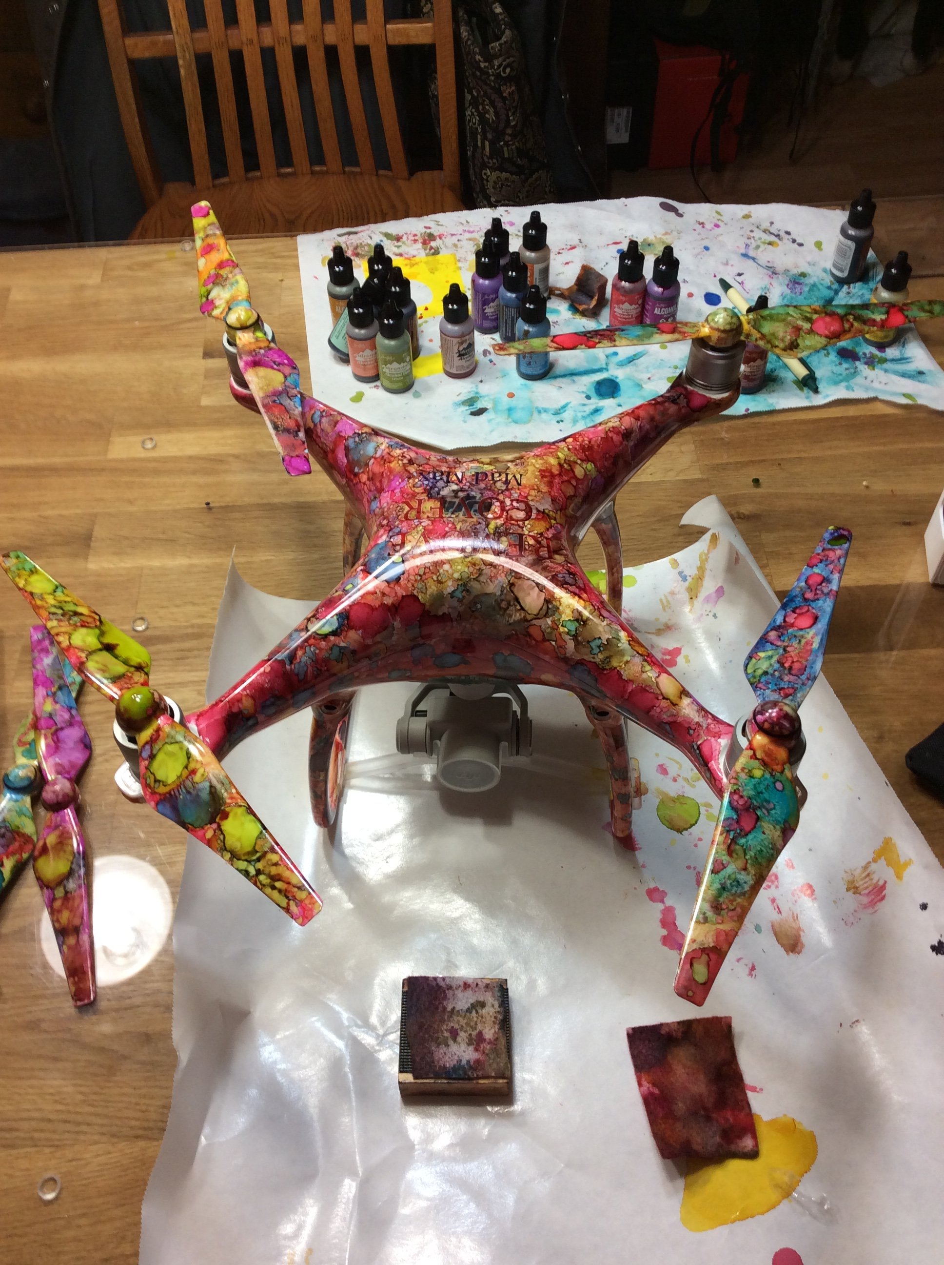

I can believe a lot of alcohol was consumed.A lot of things came to mind when I saw this. Would people believe the only alcohol used was on the drone? Clip on picture for large view.
That drone has pink elephant written all over it.
Makes me want to fly it listening to led zeplin for some reason.

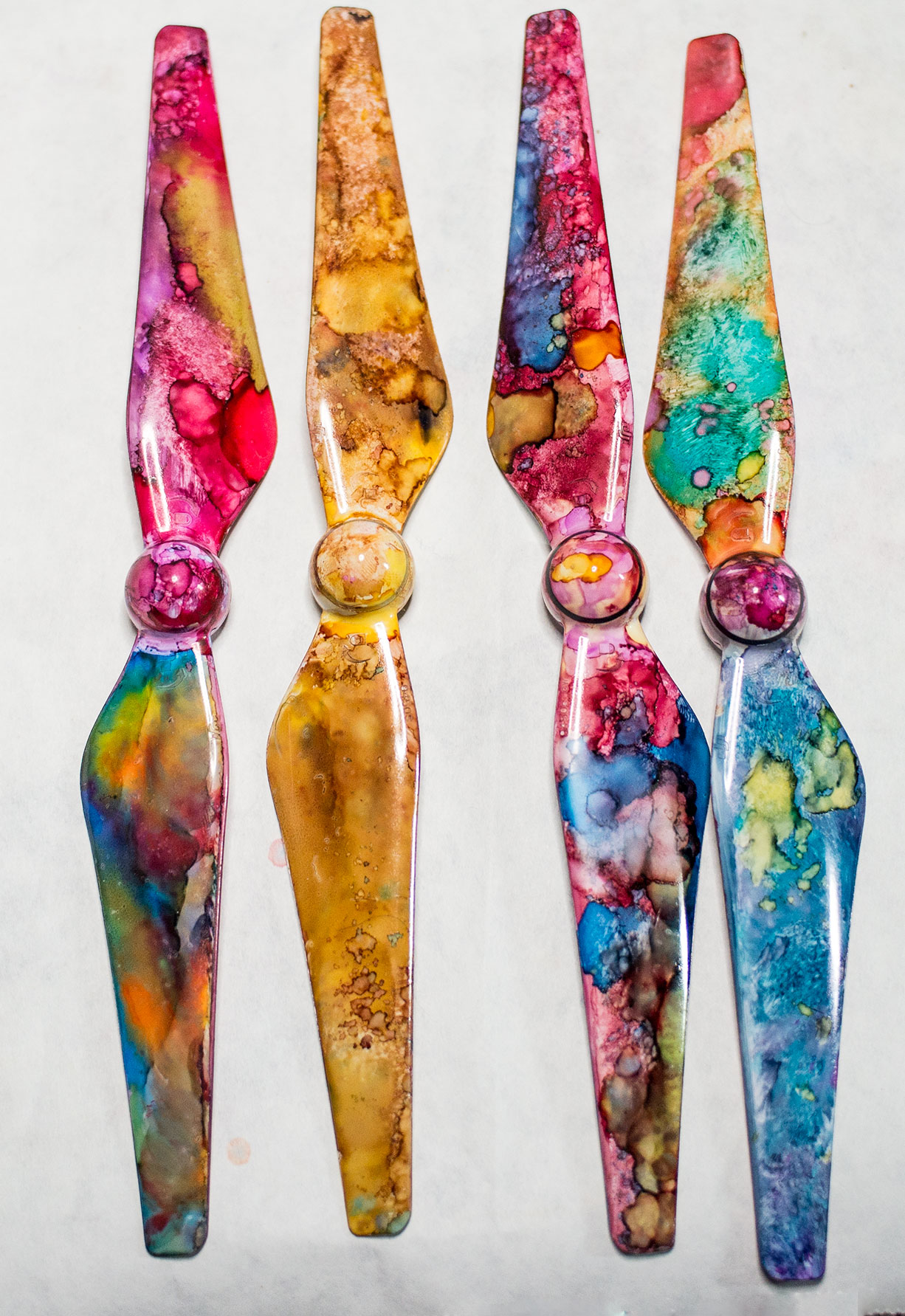

Now that looks very goodI have seen in several threads where people got creative. Thought it would be nice to see what others are doing. There are so many very talented people on this board. My wife did these with alcohol ink.

Excuse me and if I'm wrong please let me know, but aren't these blades balanced? In other words, if you have more ink on one side of the blade than than other, wouldn't that throw the shaft of the motor out of balance thus wearing down the inner workings of the motor? I know on actual helicopters one needs to be careful on how much paint is applied to each blade to keep them in balance. Just a thought?I have seen in several threads where people got creative. Thought it would be nice to see what others are doing. There are so many very talented people on this board. My wife did these with alcohol ink.

Off the chain cool! Much respect for your creativity and thoroughness in sharing the details. Thanks!Wife here - Process is pretty simple - you can purchase alcohol inks at places like Joann Fabric, Michael's or art store, you will find the inks around the scrap booking sections of the store. Also you need a piece of felt, purchase an inexpensive piece of felt while at the craft store, cut them up into small manageable squares. I would recommend using rubber gloves. You can drop the ink right onto the blade or onto the piece of felt and dab it, you can take a straw and blow the ink around, gives it a different effect, you can drop the ink on and move the item around letting the ink run. There isn't any right or wrong way, you add ink drops and go. if you don't like what you did, take some isopropyl rubbing alcohol on a piece of paper towel and wipe it off and start over. Just play. It is kind of therapeutic As far as durability, finding that it isn't scraping or chipping off at all, I was surprised, as the stuff comes off ceramic tiles really easily. So no top coat used yet. If you want to top coat it, the art store recommended Krylon Triple-Thick Clear Glaze for the tiles, and for the tiles it was several layers. I suspect that would work just fine with the blades as well.
The entire plane and props are pretty psychedelic!Thank you^ the straw trick might come in handy
