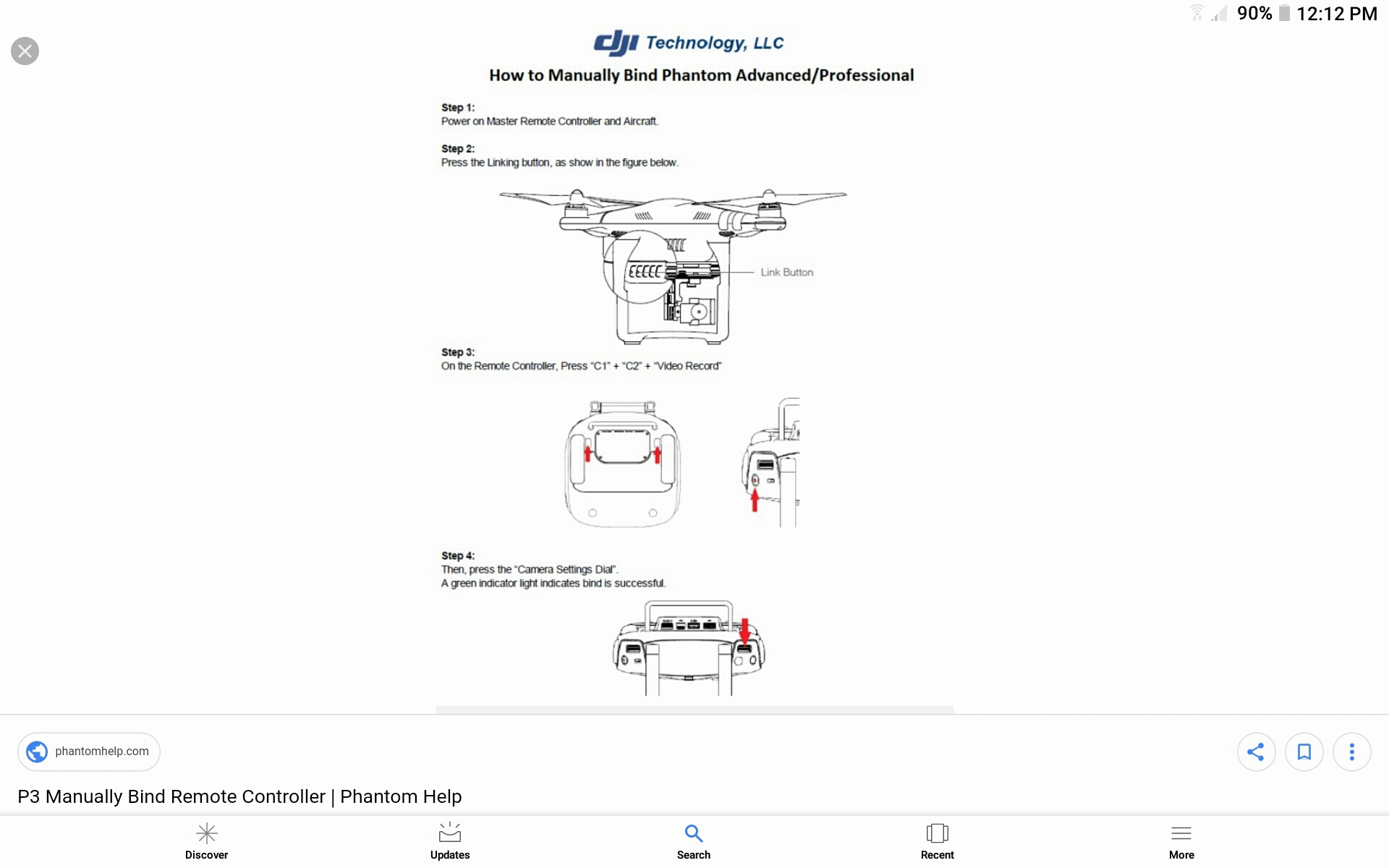

Ok,this manual link, if this not work uninstall the app and reinstall,,then try linking again,,what happens when you try link in app,?don't worry about front lights they always red,,,,the idea of a app reinstall is if you need firmware you will be prompted again then we know where to go
If try to link in the app all it states is something about frequencies, I click ok and does nothing, even after pushing the little link button on the side of the drone.
Ok that's asking to confirm frequency,,does it countdown when you press OK,, it should give you a minute...before you try again turn drone and rc on and press link button just once,this will unlink it,,then try link again-------------------have any luck
