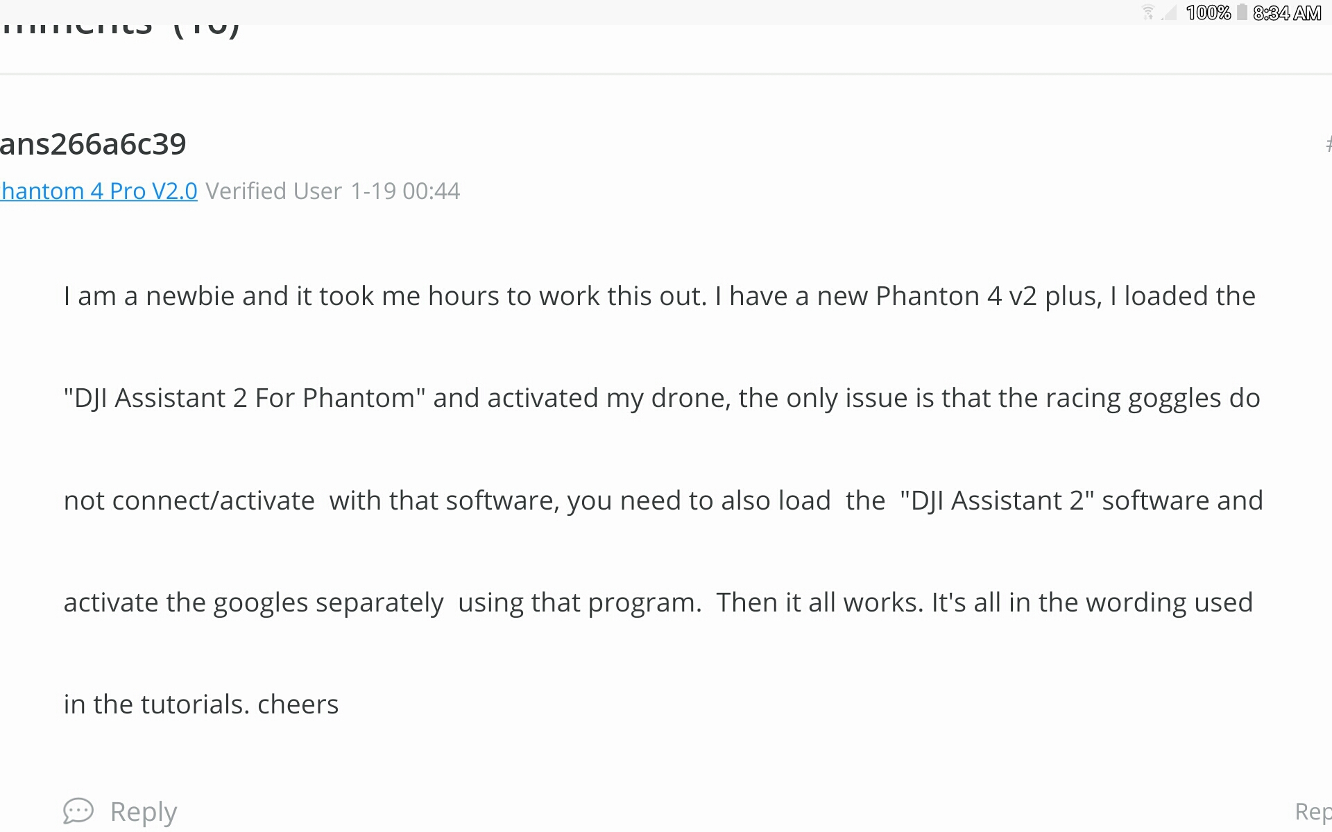

Um I did find this it might help....I had no luck with activation for dji goggles with assistant 2,,I ended up back at store and they done for me,,activation was 5 min tops,,me and computer not understand each other so noel lemming store did it just like that,,
Oh reread that, i'll go off and try to get that other software. Thanks
By jove, that was it. Crazy they don't have one program to do it all. But it activated, now to link up.
