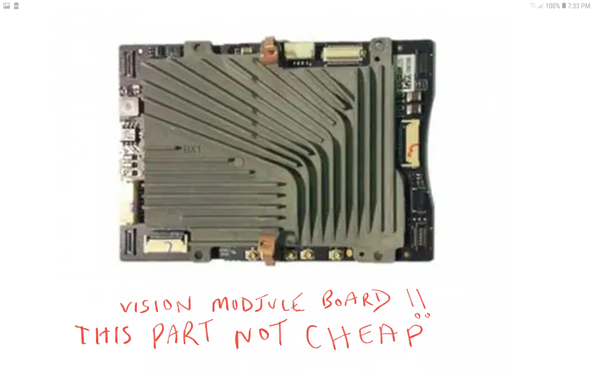

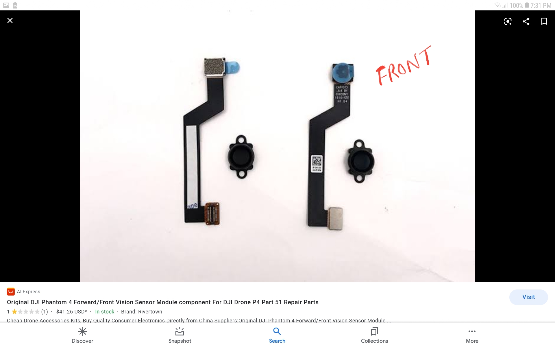

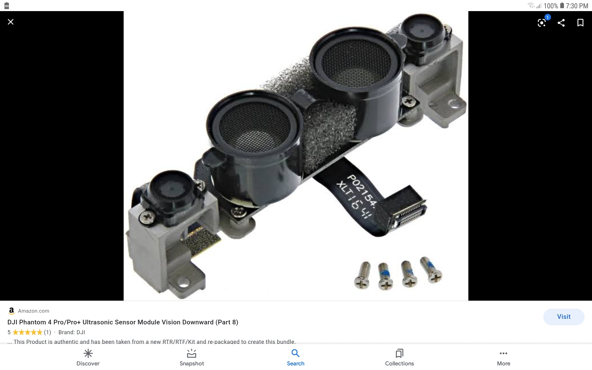

After reading heaps of posts on this same issue it seems if calibration of sensors is successful and you get error still in flight,it could be either 3 things,both are inside the drone shell.
1...vps sensor module .
2....front obstacle avoidance monocular cams
3....vision module board ......this part not cheap ,Ebay 350 to 500 depending where you buy..you might be better to buy a used crashed drone for parts...

1...vps sensor module . View attachment 121955
2....front obstacle avoidance monocular cams View attachment 121956

I just had the very same problem. After several tries at recalibration I gave up and replaced the front sensors. I calibrated it one last time and it few without issues. I can’t see anything wrong with the old sensors

the p4 only has front sensors but it is the same problem. Not that expensive to replace. they are part number 51. On eBay they go from$30 to $50 US
The P4P has different sensors and are not compatable
