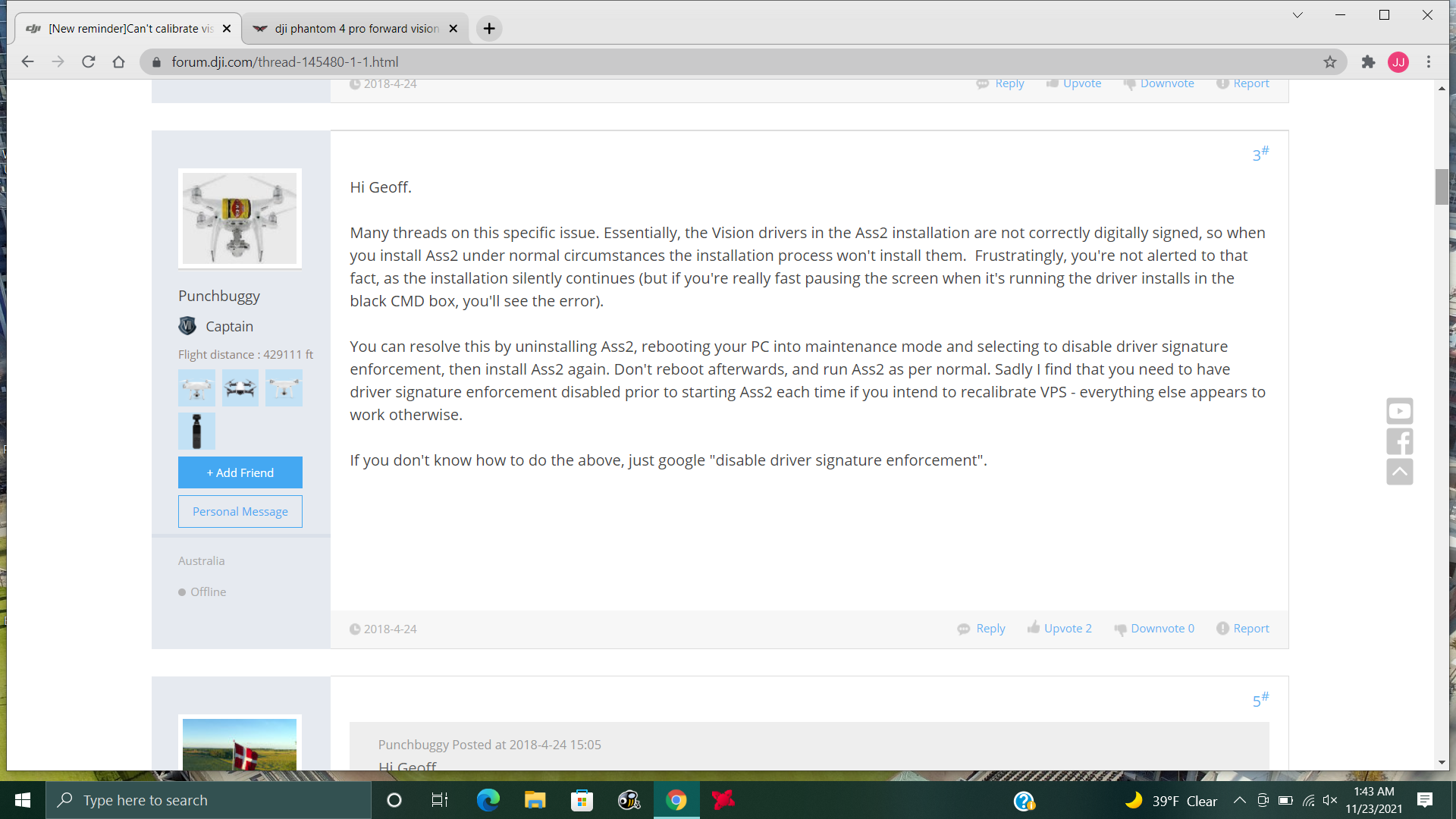

I know this is an old post but I'm betting you're still dealing with this issue and I'm happy to say I've finally figured it out. I began looking into the 'Vision Sensor Recalibration' issue again when mine started giving the error again every time I fly and Im happy to report I just successfully recalibrated my vision sensors on the very first try lol. The issue was due to the drivers in DJI Assistant 2 are not digitally signed correctly so when you install Ass2 they just simply dont install them at all due to the error lol. Its a software error from DJI. I was lucky enough to find a post from 2018 on the DJI forum from a really smart dude named Punchbuggy lol. I followed his instructions for disabling the driver signature enforcement and then reinstalling DJIs Ass2 and voila problem solved. If you're still dealing with this issue I hope this helps.
