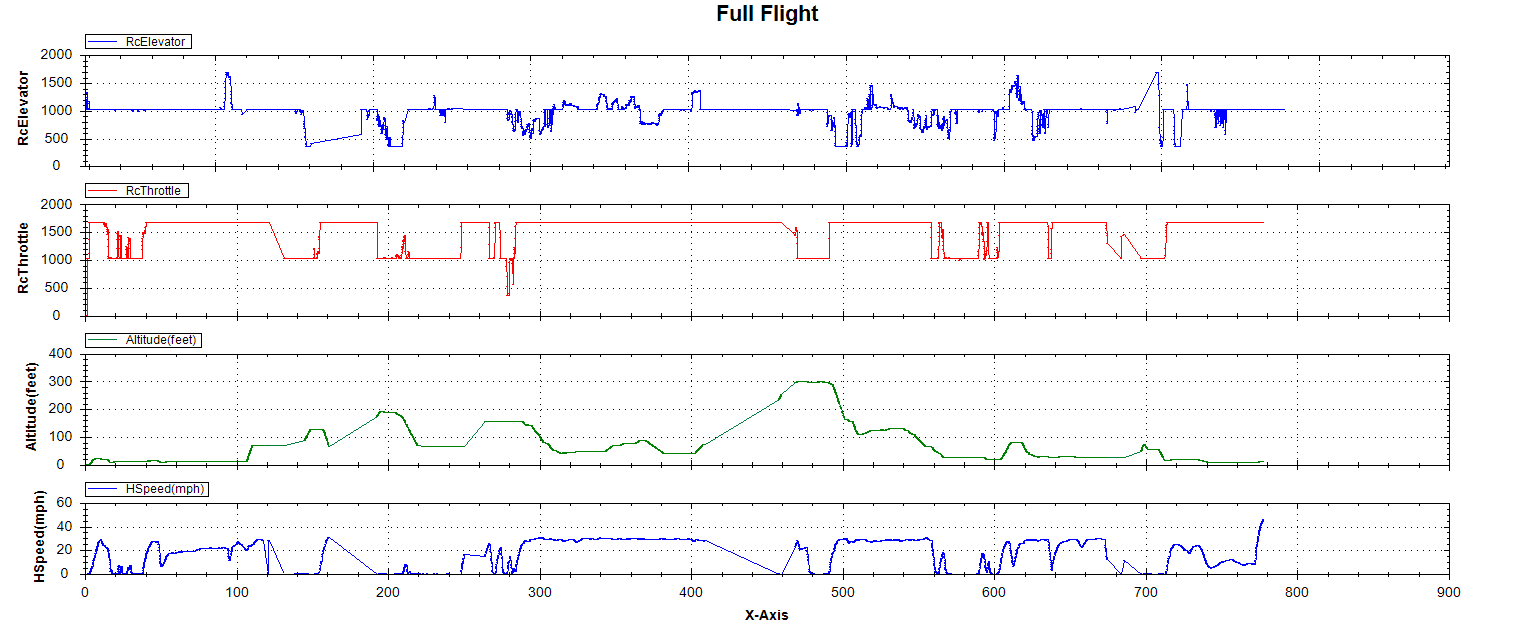

If you are simply trying to verify what you were told by DJI, the data appears to confirm what they are saying. Also, I realize that this is a mute point at present, but always turn off the VPS when flying over water. You really pushed the throttle at the very end......

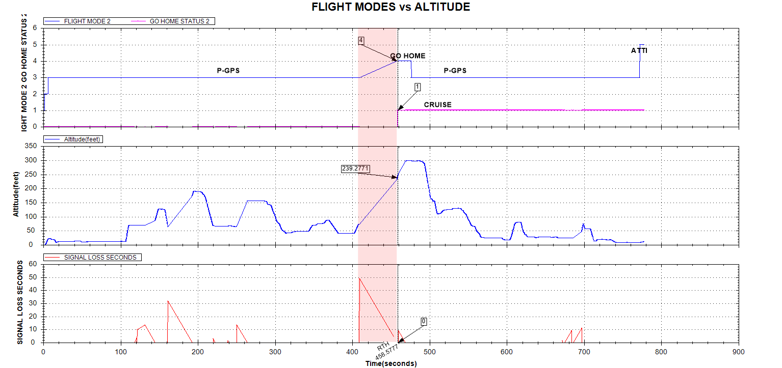

I am quite familiar with ATTI Mode. Looking back at this data again. The AC had already begun RTH at 3059ft Out after 48.8 sec of signal loss. ( It could have started earlier..no way to know for certain). Still doing a few comparisons when I get a few min. Not quite sure why the altitude loss as of yet.
Reactions: LeoTheKing76
Best I can tell, and I can't say this is not possible because I have never tried it. It appears that you were attempting to control the AC during RTH. Which doesn't make sense really because you were giving throttle up but your altitude kept decreasing. What was your RTH altitude set for BTW. Looking at the signal losses, the shaded area is the only one that was an uplink loss. The AC initiated RTH there. I will ask another to take a quick glance if you are still wanting more information. @sar104

The log data are really quite confusing because the aircraft appears to be running a custom stick mode, with left and right swapped. In the decoded logs, throttle is elevator, rudder is aileron, and vice versa.
The late switch to ATTI mode by the pilot, 6 seconds before the end of the log, probably contributed to the crash by increasing the aircraft pitch up to 35° and losing some altitude in the process. Throttle was centered and elevator was full forwards at the time, and the problem was simply that the aircraft was very low, moving very fast, and almost certainly just hit the water.

DJI's analysis seems accurate.
They can't tell what happened because the flight record ends just before the crash.
But they can have a pretty good guess based on what the record shows.
Sar104's last sentence above summarises the most likely outcome pretty well.
You were flying back at high speed just a few feet above the water from 1100 feet out with a line of trees between you and the water (if google earth is up to date).
Could you see clearly how high the Phantom was above the water?
Do you know how well the Phantom holds altitude when flying fast in atti mode?.
Altitude on your HUD is also defined by your take off position. If you couldn’t see the AC then are you certain that the water level you were flying over was the same?
-> My return home altitude was 100m thats where I always set it at just to be certain of the trees and obstructions.

That is approximately what the data revealed......The AC climbed to RTH altitude and began return. Looking at the altitude data in Post#6. Just wanted to verify that.
