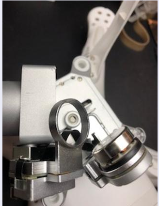

Hello everyone, before I commit. I am rebuilding the Gimbal for the phantom 3 standard, I bought a new roll motor and placed it in its proper place. Now am I suppose to glue the inner ring for support? please see attached

I believe it should be "pressed" in.
Ok... it seems that it DOES need gluing.. Watch this video, and around the 2:00 min mark it shows this procedure:
