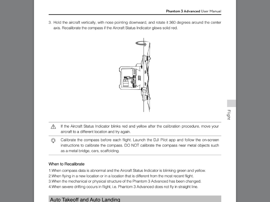

Not COMPLETELY untrue if you read the manual page 45.

fplvert, while you point out the bit you posted, it has been said again and again by blade that doing a compass cali every flight may do more harm than good.

Not COMPLETELY untrue if you read the manual page 45.View attachment 23053

IF, for some reason, your compass is ALWAYS off before you fly, then you've got an issue well outside of normal and need to return your Quad for service. Compass readings being off so much as to require a recalibration prior to EVERY flight is a hardware issue or, you're failing to properly locate the Quad during calibration. OR, you've gone a few hundred miles between locations.
