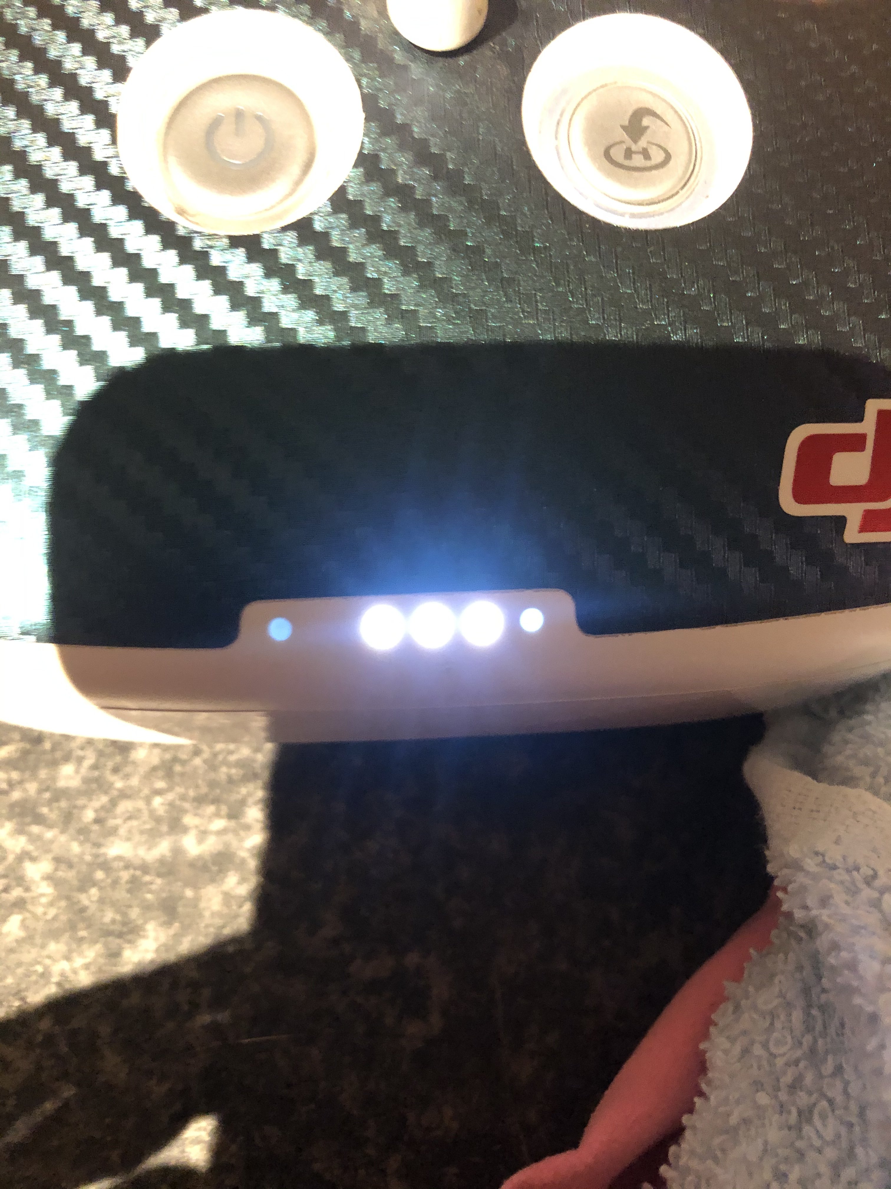

Hi can any one help and let me know what’s happening to my controller not holding charge or even charging
Not sure on this but I thought blue light had something to do with needing or in between rc update..are you able to conect with app and drone ok,there's 3 black lines top right of screen ,press and hold and it should show what firmware your remote has,,if has latest the remote might need a manual reset,,which phantom is this for ?
This sounds similar to the problem I have just experienced with my Phantom 3 4K controller. Mine showed no lights and didn't respond to the on/off button, but it still connected to the DJI Go app.
I discovered that if I opened the controller and disconnected the battery for a few seconds it resolved itself. Beware though - opening the controller yourself would void the warranty.
