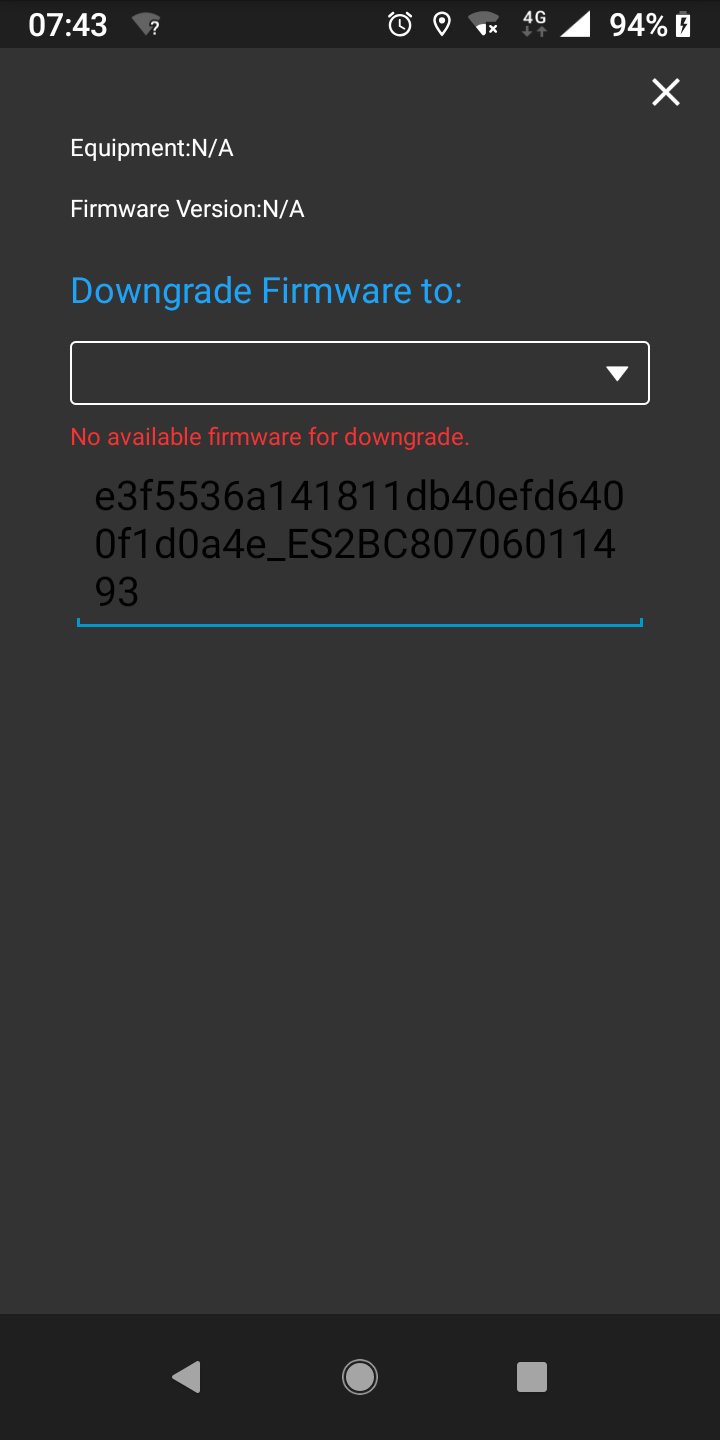

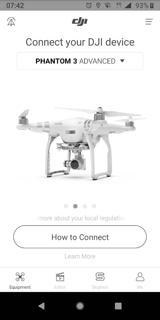

I have tried an iPad another phone I'll show you a couple of photos I have got I will upload more later when I get home from work when I try and connect

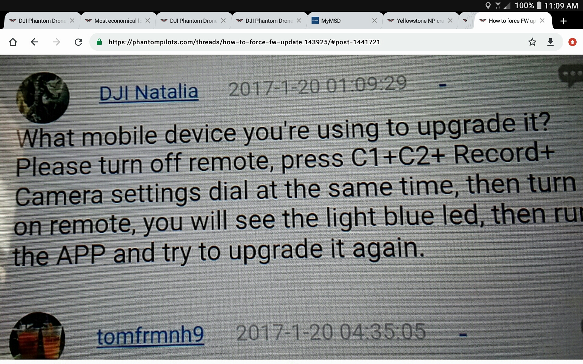

The hammer,,na serious Um this procedure helps apparently helps a firmware update (rc light turns blue),,I did post this today but delete cause I thought it not it but try it,still not sure that's the issue but worth a try

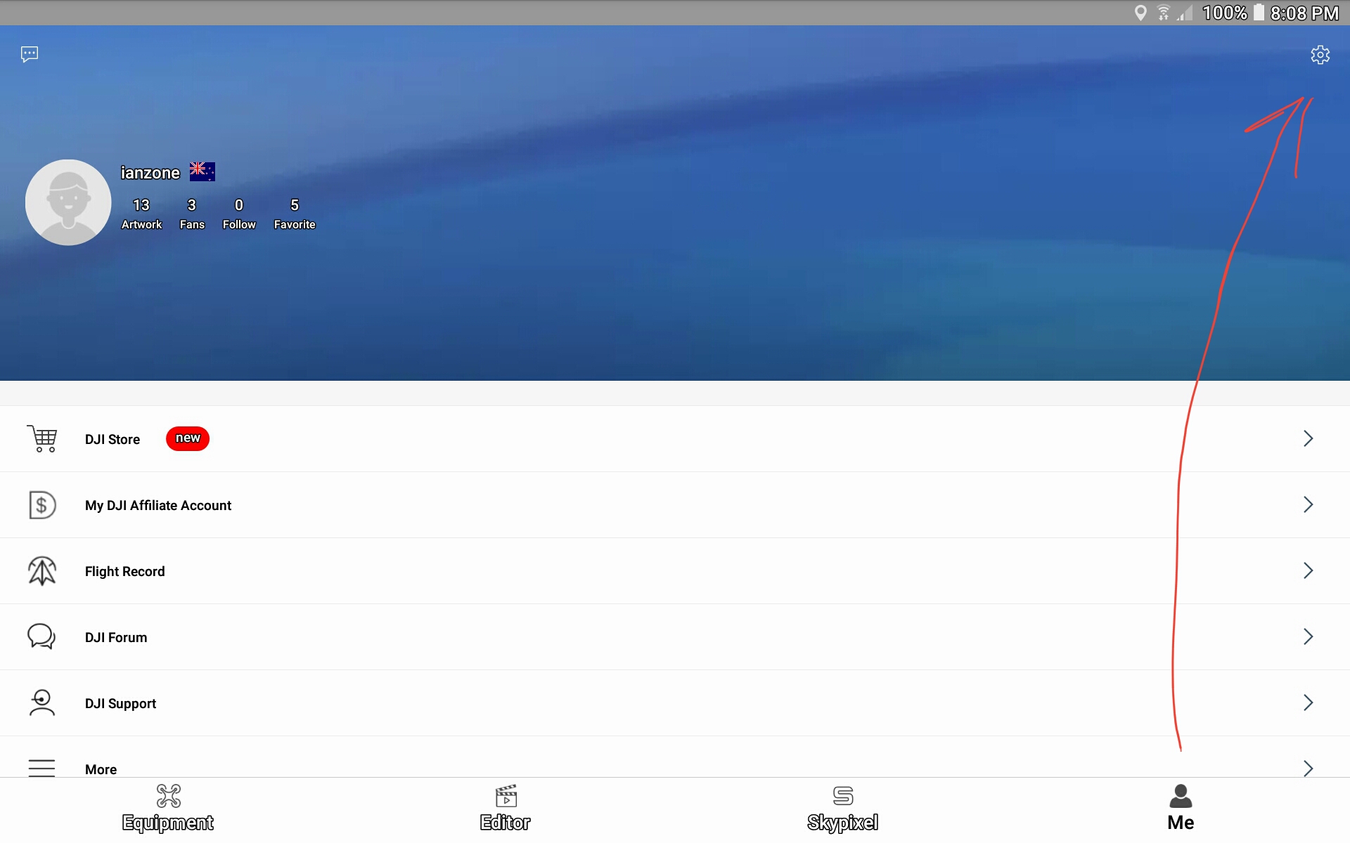

On home page click on ME and check for updates
