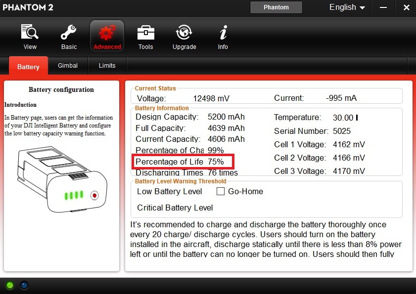

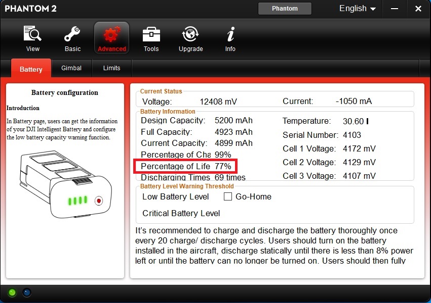

Thanks,
I saw the battery specs, and it turns out that need to be replaced

The first picture shows a healthy battery, the cells are all within tolerance levels but the second one is well and truly goosed, still try a deep discharge anyway

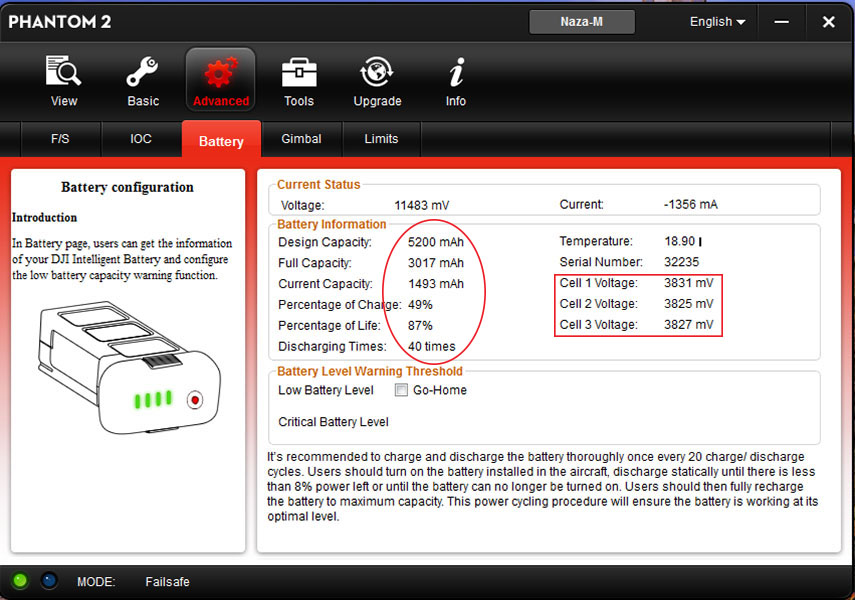

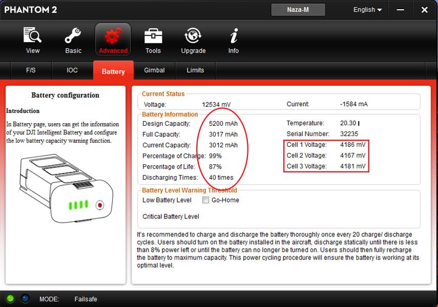

You cannot rely on the 3 cells voltages to be absolute as long as all 3 are 4.1v as batteries have parallel pairs. What you should pay attention to is the current levels as the lower the third figure the quicker that battery will drain. If you are not using an FPV system with OSD it's hard to tell when the battery reaches 10.6v and should on the ground at its home point.
Before charging.
After charging
This battery lasted less than three minutes in flight and was over 100 feet in the air at the time. Luckily I was able to land it safely and voltage level was fluctuating between 10.6v and 10.5v. I simply was not paying attention to the OSD reading on my monitor. It's a good practice to check your batteries in the P2 software after charging and before each flight.
