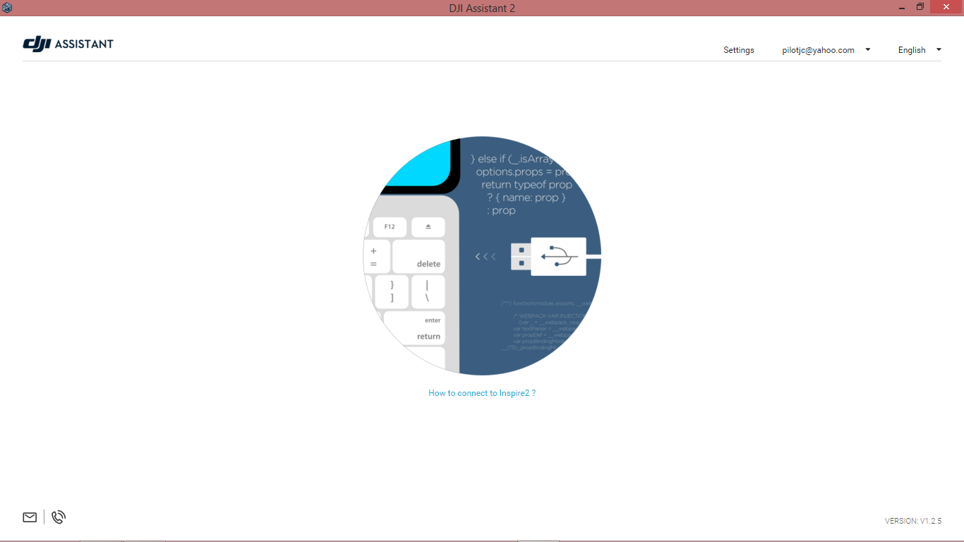

Hello
I just received the HDMI module and have installed it BUT I have yet to make them work. My RC did prompt me to upgrade new software and it did it automatically but I can not see thru my goggles. I tried doing it thru DJI Assistant 2 but when I plug the goggles to my laptop it never prompts to download it, what in the world am I doing wrong.
This is all I get.

Hello
This is all I get.

Good morning
I tried on another laptop and it was a success, perhaps my personal laptop was not doing something right. I have functional goggles guys so thanks to all for all the advise.
