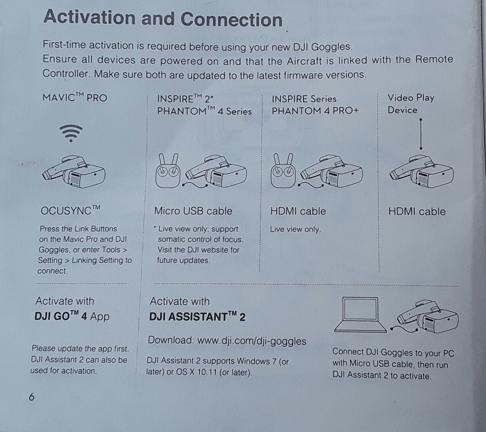

Good day All , I'm new here and I just brought my first drone (Phantom 4 pro v2.0) with the DJI goggles I have updated the drone with (01.00.1500)and the goggles (V01.04.0500 date 2018-09-03) but I cannot get them to pair, can anyone help please?
Have you activated your goggles,it's not mentioned so thought I ask...Good day All , I'm new here and I just brought my first drone (Phantom 4 pro v2.0) with the DJI goggles I have updated the drone with (01.00.1500)and the goggles (V01.04.0500 date 2018-09-03) but I cannot get them to pair, can anyone help please?
Ah very good,yes at time this book was made the p4pv2 didn't exist that be why,,I did forget to mention Ocusync ,older p4s won't Ocusync either which I have so had to add moduleThank you for your help, yes I activated the goggles, the information you show says that the ocusync only works with the Mavic Pro but it also works with the Phantom 4 Pro v2.0 and I can get it to work
Are you saying that the P4P V2.0 won't work with the goggles
