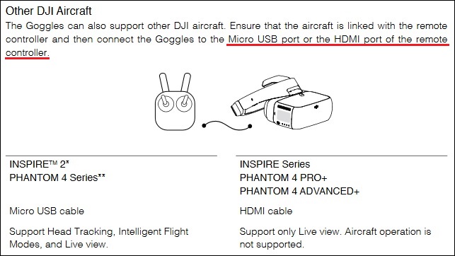

Per the DJI Goggles manual, the DJI Goggles can be connected to either the micro USB or HDMI port on your remote controller. Your tablet connects to the USB port.
The goggles can be connected to either the micro USB or HDMI port on your remote controller. Your tablet connects to the USB port.

I answered your question above twice. You cannot connect the DJI Goggles to the USB port on your remote controller. You must connect them to the micro USB port OR the HDMI port. That means the USB port will still be available for the mobile device you normally use when flying.

I did some more digging to try to find information from people who actually own the DJI Goggles. Here's what I found:
1) There are a few DJI employees running pre-production DJI Goggles models here on RCGroups. They said the DJI Goggles manual is incorrect. The DJI Goggles can only be connected to the HDMI port or USB port on the remote controller.
2) Alan Chan on RCGroups showed a setup of the tablet and DJI Goggles running at the same time via the HDMI port connection (see this post). This is no surprise though since the HDMI output on the HDMI output module has been tested with many other goggles/glasses models.
3) In this post on the DJI forum, Craig confirmed a mobile device cannot be used when the DJI Goggles are connected via USB. I'm not sure if he is using a pre-production model.
4) In this post, @Frostywinter said a mobile device cannot be connected at the same time since the DJI Goggles connect via the USB port on the remote controller.
That said, I can only assume the information in the DJI Goggles manual is incorrect. It does not seem the DJI Goggles can currently be connected to the micro port on the remote controller -- as shown here:

Ok, Thanks for that input, this sounds more like I expected. Manuals can sometimes be somewhat misleading.
Cheers!
Perhaps it's a feature that hasn't been implemented yet. An older version of the DJI Goggles manual showed head tracking was available for the P4. The current version of the manual shows it's not available. On RCGroups, DJI employees are saying P4 head tracking will be available later in a new firmware release (release date unknown).
I think if everyone understood that the goggles are basically a tablet on your head running software then you'll understand why things work the way they do. It has a version of DJI app software running on them. This of course is all disabled by just using them as monitors thru hdmi.
