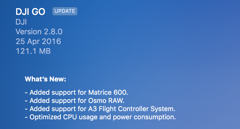

DJI go update 2.8.0
Litchi also updated today.
