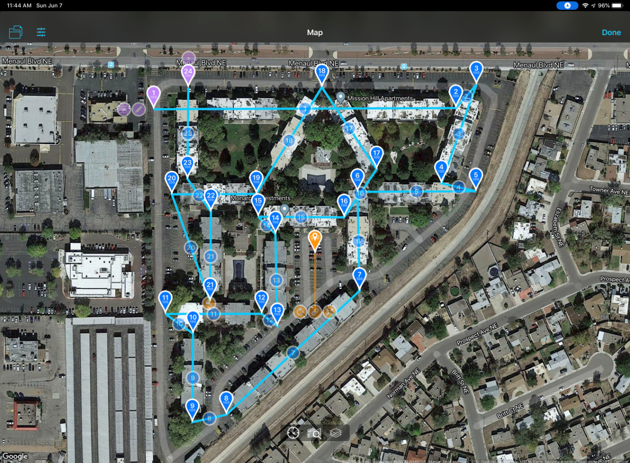

I shoot video, 30 FPS. I use my Inspire 1 for my construction progress videos. That just said, I just scored a gig for roof inspections, which are not going to be your traditional roof inspection videos. These are all apartment complexes. After sending a couple test videos, the owner decided he wants me to shoot them nadir @ roughly 6 mph. I will tweak the speed per his spec. These are huge complexes, so I've set the entire mess up as a waypoint mission for repeatability. Why am I telling you this? Because for the first time I've decided to use my P4P with Autopilot. Here's one of the missions. It's 1.1 miles long and @ 6 mph will take about 11 minutes to complete.

Wow, that roof inspection is a complex thing. I can see how AutoPilot (Or Litchi) would be hugely helpful in a precise pattern.
My background is primarily stills, but I need to up my Video game & am still very basic in my filing skills. I do it, but turn over raw footage to someone who knows how to edit...
Questions:
-How high above the roofs will you be? Are all the building basically same height or did you have to adjust altitudes on the waypoint mission?
-And at 6mph will he be able to freeze a frame to really examine an area for problems?
-Will that also be 1/60sec @ 30FPS or would you bump to 1/120sec @ 60FPS for sharpness?
-4K or 2.7k? File sizes must be huge...
Honestly, without waypoints it would be nearly impossible to do, and very impossible to repeat. These inspections are going to be ongoing, 2 or 3 times/year.
Depends on the width of the apartments. It's all a bunch of geometry. The apartments I cited are 36-42 feet tall, and roughly 70 feet wide. The P4P lens has an 84° FOV. Naturally I want the entire width of the roof to be in the shot. So given a roof elevation of 40 feet, loosely utilizing the Pythagorean theorem, I will need to be about 40' higher than the roof. But I want some wiggle room, so I built the entire mission @ 100'. I may tweak that once I start flying. I was going to fly test flights both yesterday and today, but it's just too windy this morning. Maybe later or tomorrow.
They're basically the same height, but I may tweak each waypoint to fly a custom height per building. But honestly I'll probably just find a good general height and adjust the mission altitude globally.
Absolutely. I'll be shooting about 1/2000 shutter speed. At that speed you can freeze a 60 mph car in its tracks. Each frame should be very sharp.
1/60 @ 30FPS would be very tough to expose properly. In addition, the slow shutter speed would net some motion blur, which I absolutely do not want.
4K. The file sizes are pretty big...but not huge. This apartment complex will probably be a little more than 1GB.
