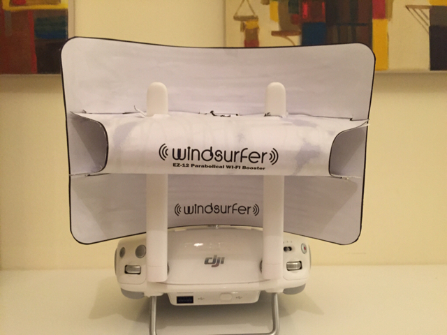

thats my new version only one piece
Can't wait to start seeing some reviews of this 3D printed piece. I could have used it today...
View attachment 25357thats my new version only one piece
There was a guy at the park that took some cardboard and aluminum pan and cut out the antenna without a template. funny thing was that it actually did improve his signal a little. I guess the main reason was that it blocks noise from the back.
But the problem with your design and his is that its not reflecting the signal to the antenna, so you are only blocking signal from behind the booster but not improving whats in front of it....
I noticed that you only need 1 antenna with the booster on, since its a MIMO system. So you are better off using the original design only on 1 antenna and moving the other antenna out of the way...

The parabolic feature is lost in many of these attempts to improve the reflectors.
Without proper focus they're not much better than a flat plate.

I'm not a expert on this but being that it is a MIMO system (using more then one antenna) Wouldn't you want both antenna's to be supported by your booster?
Yes in a MIMO system you MUST have all antennas modded to achieve the best results. Only in a diversity setup like with the Phantom 2 vision could you just do one.

We're dealing with electromagnetic radiation, 2.4GHz, so let's use a higher frequency, light, as an analog...
If you hold up a flat piece of foil or other reflective material towards the Sun you can create a refelction onto a secondary object.
Now, focus that same refelction by warping the reflector appropriately and it is obvious how the energy is concentrated.
So even a flat plate will produce results but a focussed device will be much better.
As far as both antennas being aided, it makes sense even IF one is Tx only and the other Rx only.
To achieve BEST results for bandwidth, not for range... You don't need the highest bandwidth to still have a decent 720p picture. By having 2 antennas out of polarity (in the V shape) you're just making it worse by using them as the OP has shown. By using only 1 and keeping the antennas perfectly vertical I got equal results. Actually I even went as far as to keep one antenna horizontal to the ground and the one with the reflector vertical and I still got the same result... So what that means, is that I can actually use a bigger reflector like the original 12dbi windsurfer on 1 antenna and get even more range.
Just because its MIMO doesn't mean both antennas need equal signal, or that both antennas both get signal. Only 1 needs decent signal...
