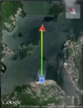

Using this mod with a app that has a mod referred to as "wifi wand" is the best options overall. See image below for a reference:
I'm interested, and mostly because your setup appears to be on point for best performance. It matches the curving detail of the antenna's and is made keeping the distance of the antenna at 1/2 inch from reflector surface.
It's called Pilot Wand – Helps to maintain pilot’s line-of-sight (LOS) and device aiming toward Phantom with different color based on RF signal strength (strong > weak, green > yellow > orange > red).

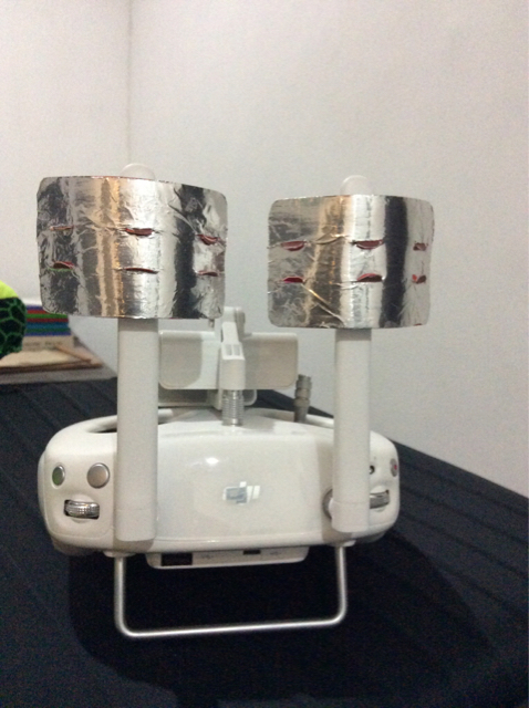

Hi Guys!!!
I would like to show you my antenna reflector booster. Work's great.
I flew 4,500m and still I had full range. I decided to come back because I wasn't sure about battery but when I came I still had 31%. Next I will try to fly farther to 5000m.
Instead aluminum tape I used to can of beer in my opinion is stiffer and I connected the both antennas together.
I know that not looks well but it's my 1 prototype. Next should be better...
I am satisfied

The can of beer booster looks nice. Did you cut the can into 2 pieces or just fold it over?
I used only one can of beer cut in half and after that little bit more cut both sides to hold both antennas straight vertically. The can of beer is curve profiled and has smooth surface = better reflection.
