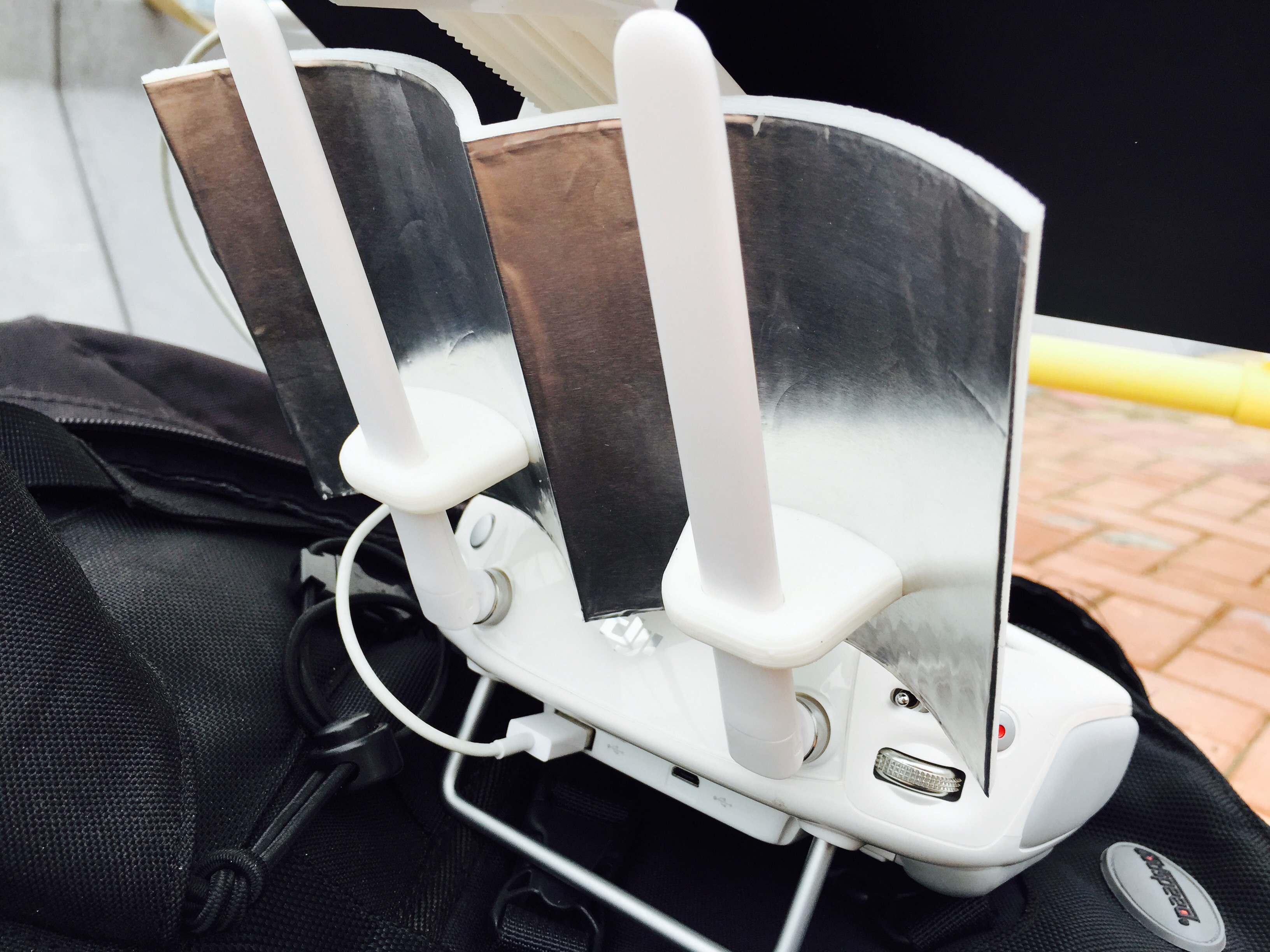

Just got back from using David's 3d printed booster. I can confirm 100% this works great. I normally get 1,800 or 1,900 feet out before I get a weak signal when I fly in the city. Tonight I got 3,068 feet.
I was worried that it would make the signal too focused but I didn't find that to be a problem at all.
The only slight issue I have with the device is I have to apply more pressure than I would like to the antennas to get them to snap in place. I'm extremely careful with most of my belongs so this is probably just me. If he made it much looser - they probably wouldn't hold.
Overall, I'm extremely happy. Thanks David!

My antennas snap in place firmly...Try holding the antenna right above the keeper and gently rotating the antenna until one edge clears one side of the keeper and it pops right off with less strain.

This booster looks great, people seem happy, and the results speak for themselves. I have one question though... it's recommended for the antenna to be in somewhat of a "V" formation, whereas the booster (as far as I can tell) locks then into a parallel orientation. Has any testing been done with printing the parabolas to allow for the "V" formation? If yes, what impact did this have on performance?
No, it's NOT recommended to be in a V position. Parallel as shown is the correct position.
I could've sworn I read that in the manual. I went back and checked and it does show parallel being the optimal configuration. My mistake - disregard!

Personally, I prefer slight "V" (<20 degrees vs. vertical) antenna setup to keep antennas slightly apart for lowering interference and improving diversity gain.
