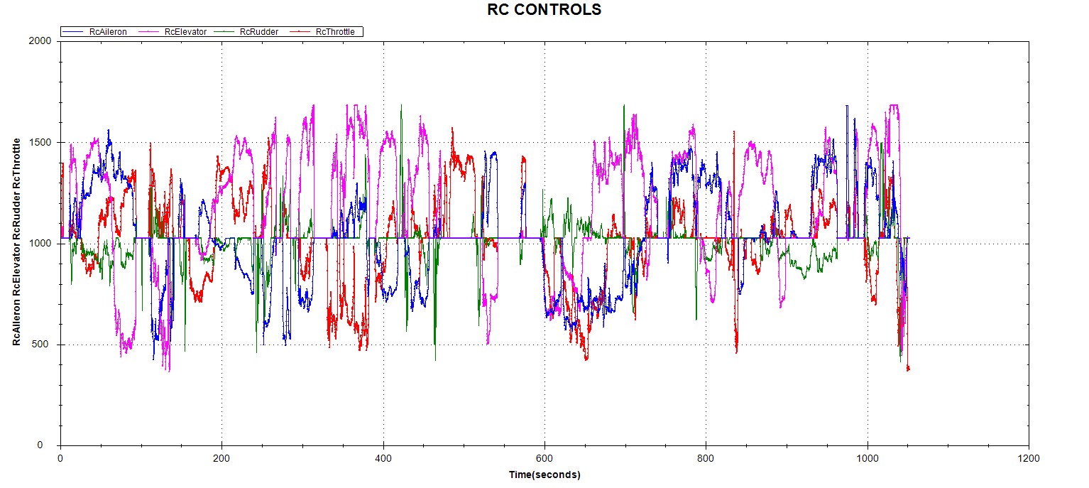

The .dat files are most certainly not correct. The .txt file may or not be. In any event, this flight was a low battery RTH not initiated by you. I saw no signal discrepancies whatsoever. I am posting the battery data and location to verify that this is the flight in question. The correct .dat file will give a better answer, but this was obviously low battery RTH.
And you were correct in your statement, you did have full control for the entire flight. Unfortunately this data does not provide uplink and downlink signal strength, so I can't differentiate between the two, other than the uplink was there for the duration.

And you were correct in your statement, you did have full control for the entire flight. Unfortunately this data does not provide uplink and downlink signal strength, so I can't differentiate between the two, other than the uplink was there for the duration.View attachment 99448

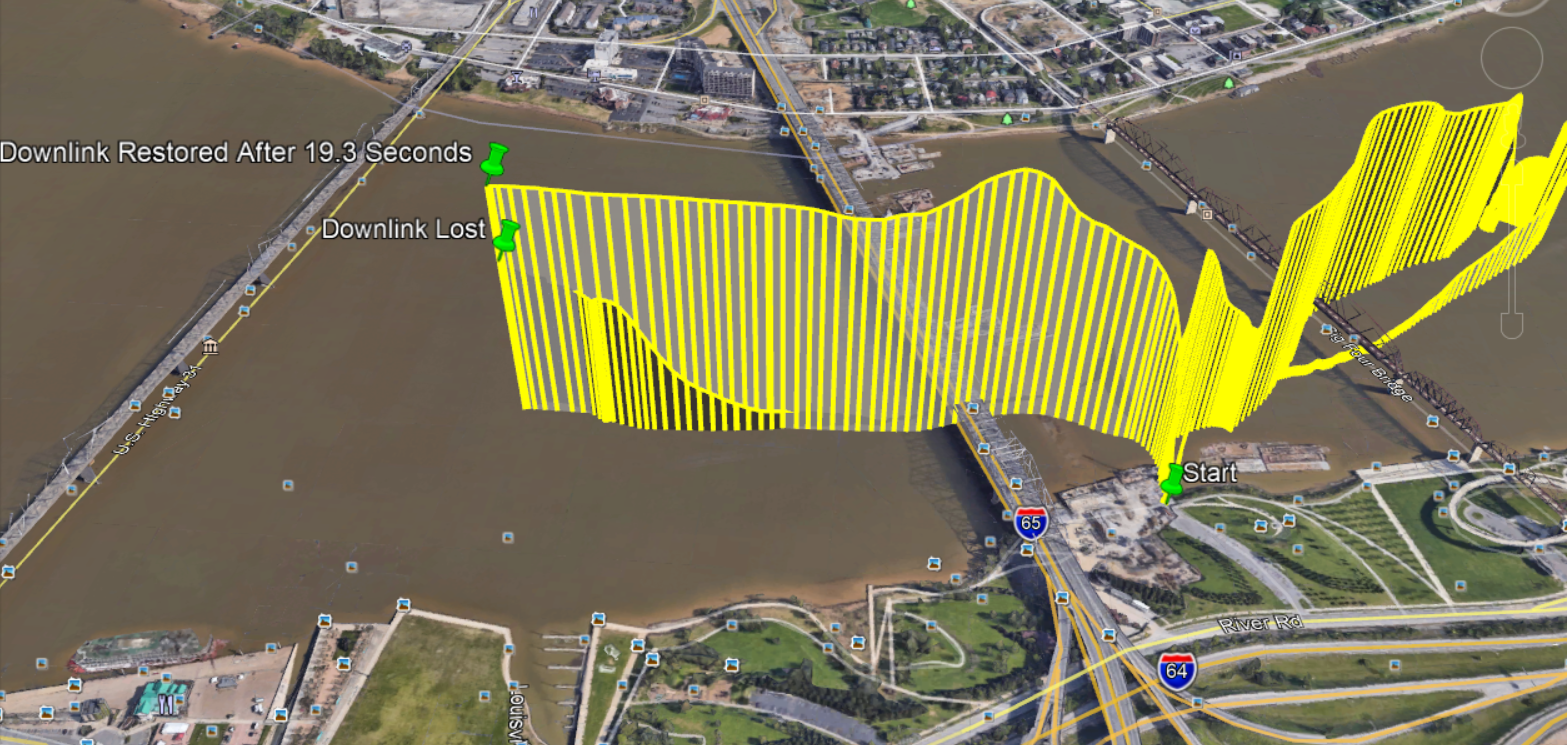

Only one of these flights revealed any sort of signal loss and this was downlink only. Below is a 3D GE representation that shows the loss and restore points. There were a few battery cell swings but they recovered. Other than a few GPS Mismatch errors ( Which usually don't pose an issue) , interference messages and Airspace warnings, there was really nothing else out of the ordinary. You can always look at the RC status light when you lose video feed to check RC connection.
Thx for the help FlyDawg! I flew yesterday and had no issues at all. Lot closer on this flight but no issues. I just would like to know why the app is saying aircraft disconnected when it's only the downlink that has failed? I truly think it was an app issue with Ipad Air 2 device. I had to do weird questions before my app opened up yesterday. So maybe an ipad update has fixed the issue already. I think DJI is outgrowing the 2 year old Ipad Air's! LOL
