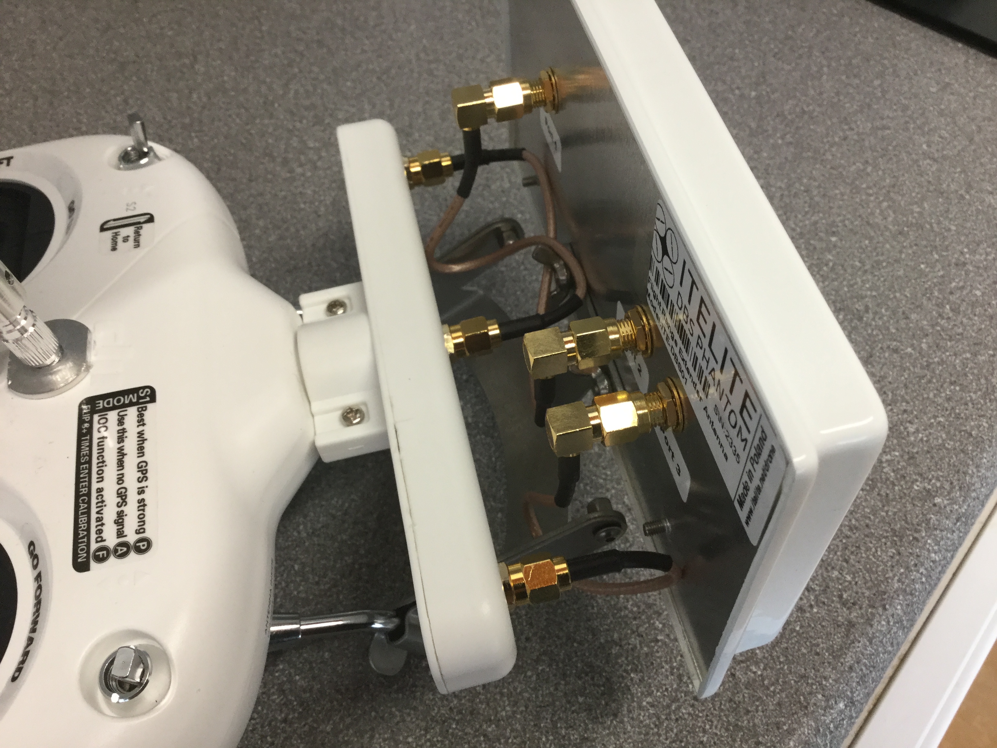

Very good, like the look. Here's mine before and after the amps.View attachment 77204 For those that are upgrading to the dbs itelite mod , if you've tried the argtek range extender like I did, and you don't really fancy drilling holes in your Rc , this was what I did and works flawlessly

Absolutely. If you have a look at the picture which i hopefully posted correctly lol you can see what looks to me like a additional notch that would be more suited for the bar coming off the standard at 45° or so. I sent them a email the day before I bought, didn't get a reply so I bought it anyways! Lol i will post it if it works and let you know if it doesn't. [emoji482]Let us know if it fits (w/o mod) to the P3S. I saw this way back and didn't get it because I thought it won't fit the Standard.
