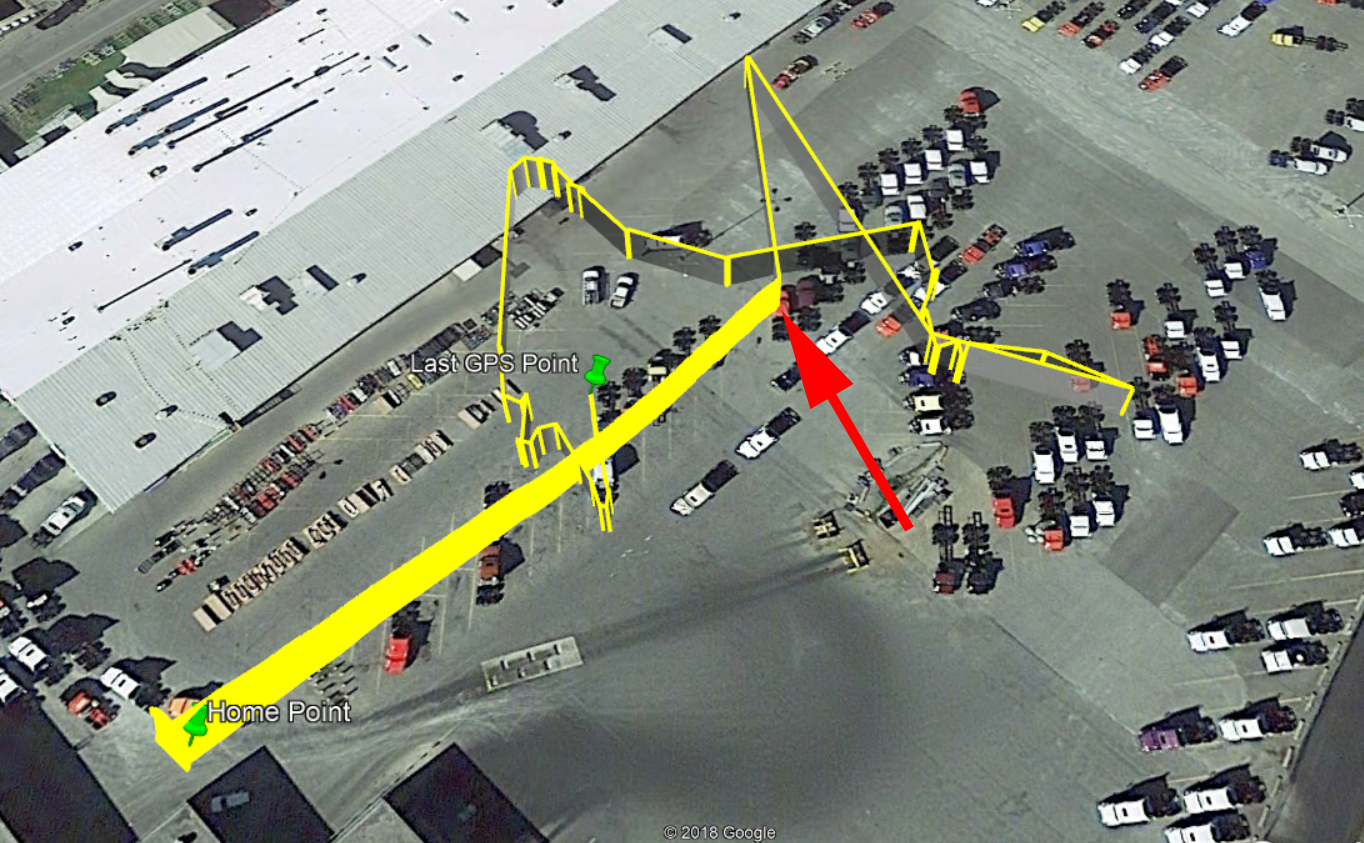

If this is the flight in question, it certainly looks like you had GPS issues. In the GE photo below, notice basically solid yellow line before the red arrow. These vertical line's are each reported GPS position for the entire flight, per the .dat file you posted. Notice after the red arrow these vertical lines become few and far between which says that the GPS reporting was intermittent during that portion of the flight. As to why this is I can't say as of yet, but that is what I am seeing.

Thank you Fly Dawg. I really appreciate it! So the weird thing is, the drone never made it to the right side of the thick yellow line where the arrow points. Once it got to that point, it veered left and slammed into the hangar wall. The battery fell out and I took the drone straight back inside. Im pretty sure this is the flight, both the date/time stamp and the flight path support that this is the flight in question.

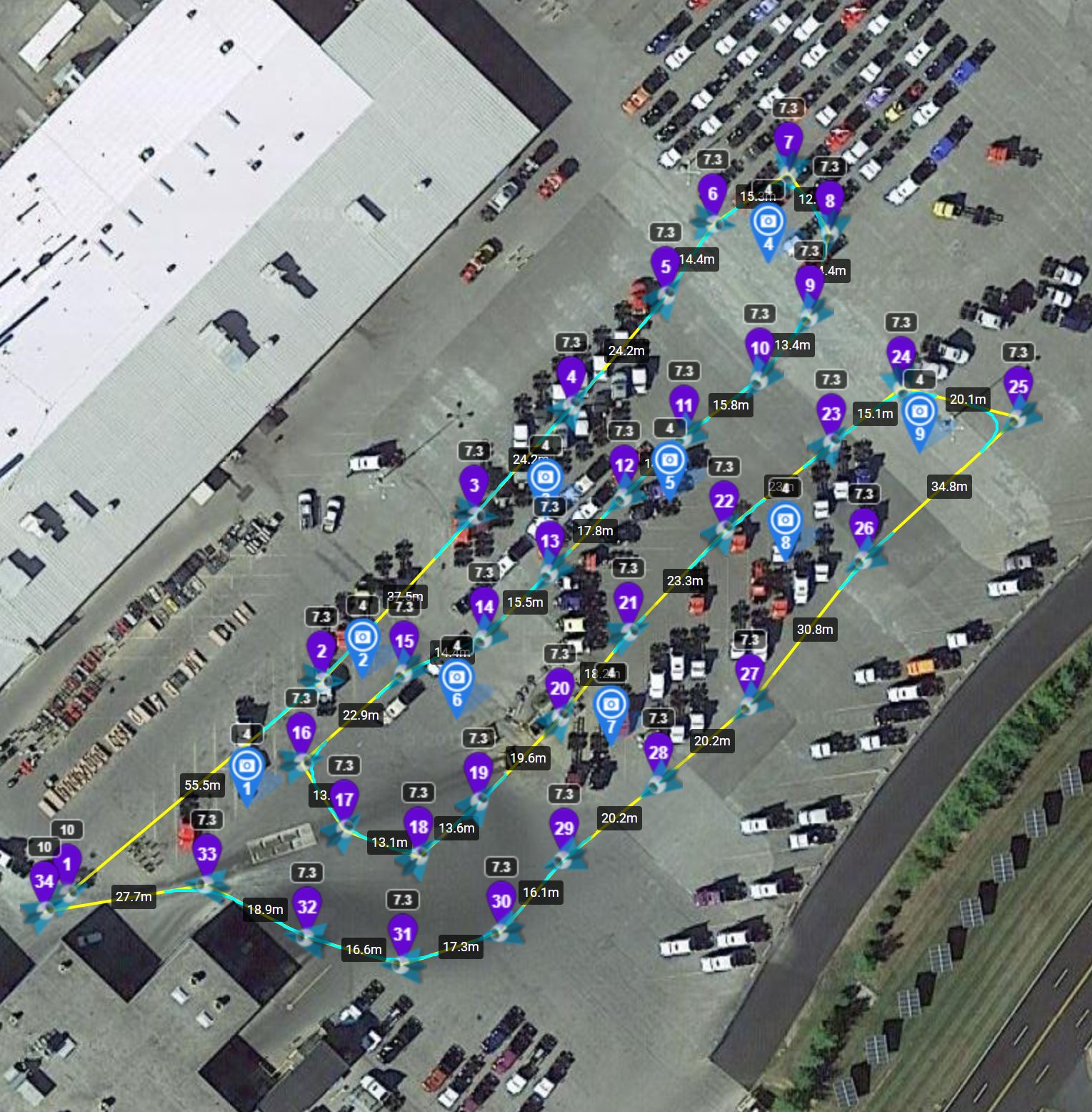

What happened is this: I manually took off with the aircraft. Once it was at a stable height, I loaded the waypoint mission using Litchi and the drone automatically went to waypoint 1 and started its path. On its way from waypoint 1 to waypoint 2 I lost sight of the drone. I was monitoring the app, and a little bit after reaching waypoint two, I could see the drone veering to the left, and as soon as that started happening I got an audible: " Warning: Disconnected " message, im not entirely sure if it was the remote or the Litchi app. I tried using the joysticks to control the drone but I didnt have control. At this point, I still cant see the drone, so i run to a spot where I can see it and as I'm running over there, I try switching S1 hoping to gain control but I'm thinking it was too late as when I got to the spot to see the drone, it had already crashed into the wall and was falling down. The battery fell out and was damaged pretty bad. The drone only suffered cosmetic damage and two of the pins holding the gimbal fell out so I replaced them and the battery. I automatically took the drone inside with the battery out. It never moved to the right of that point as it was only on waypoint 2 when that happened. I attached a screenshot of the waypoint mission from mission hub in order to help visualize.

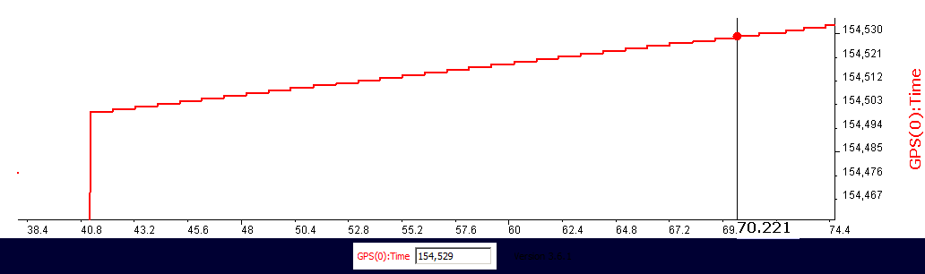

Let me just add that it appears the GPS receiver didn't disconnect or go intermittent. Looking at the GPS:time signal it cab be seen there were no gaps in the interval immediately preceding the jumps.

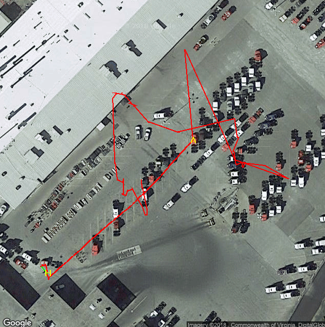

The AC was here

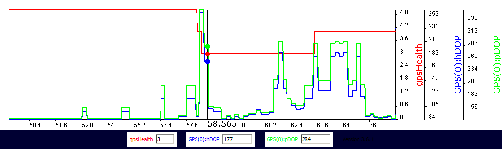

A little before the jumps there was an increase in the GPS Dilution Of Precision and then drop in gpsHealth.
Why did all this happen? Don't have a clue.

Can you share your mission from the hub, the mission not a picture?

No. The solid line is not actually solid. It is reported GPS points from the logs. The more solid the line. The more GPS points that are reported. When the line is seperated and not equal in separation. The GPS points are reported far and in between. This was from the actual positioning file that was provided.

No. That is from the actual data. An easier way to think of it would be like a fence. The "solid" yellow line may have a fence post every 2 feet. Which at the altitude you are looking at on GE would make the line appear solid. After that you can tell by the image that the "fence" posts are now far away from each other and random.
There is an important distinction to be made here. It's not that GPS started missing some of it's reports. Rather, the GPS continued reporting at the same rate but the coords were incorrect. The jump from end of the arrow to next to the hangars isn't physical - it didn't actually happen.

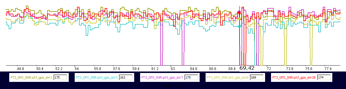

I was tempted to think that being in the vicinity of the hangars caused the increase in Dilution Of Precision which, in turn, caused the incorrect coords. But, that's nonsense since DOP is dependent only satellite position.

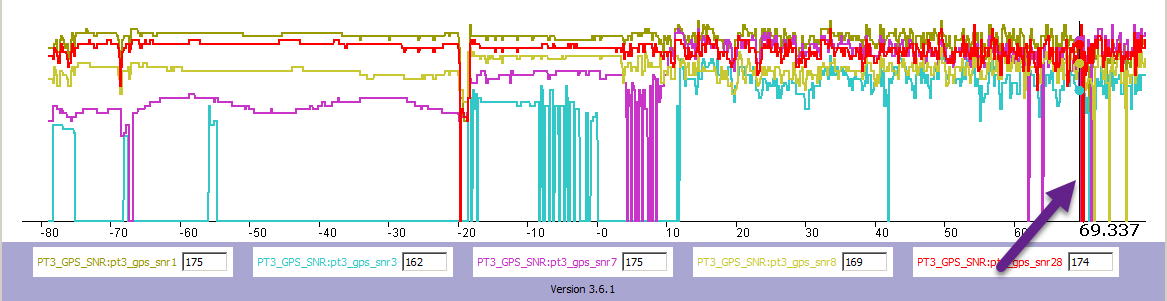

But, maybe reflections of the hangars caused some jitter and reduction in signal-to-noise ratio for some of the sats. I looked through the sat SNRs and picked some that seem to show this. Time 69.42 secs corresponds to the beginning of the first jump.
To be sure there were several such SNR drops by the individual sats over the flight. But, several seemed to occur at 69.42 secs
BTW, the sat SNR sigs are experimental. To see them CsvView has to be told to present them.

I'm supposing the noise is the form of jitter - which is actually a technical term. The sat signal bounces off a hangar which causes two signals to arrive at the GPS receiver. The bounced signal has a longer path and arrives a little behind the direct non-bounced signal. The signals are just a stream of bits, each being on or off for a certain length of time. The problem is that the beginning (or end) of a bit can be compromised by the longer path bounced signal. It's called jitter because the transition between two different bits won't be clean - it'll go back and forth before finally settling on the real value.
