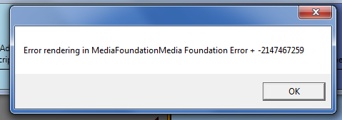

Has anyone else got this error, using Windows7, when trying to Create Video from Dashware?

Not sure if I got the same message, but I found Dashware can't handle hi-rez files. I think I had to knock it down quite a bit in Vegas and use the lower rez file when using Dashware.
Yes, same here. 1080p max from what I see. If that is not the issue, then mabey a missing/corrupt codec.
THANK YOU, you were both correct.
I reduced the video quality and it worked.
Thank you for the help !!
I discovered that if you have an audio track embedded with your clip--you can render 4K with dashware. For example, I use Photoshop to render out a clip, which includes an audio track (with no sound). I can then use that 4K clip with dashware to create a video, and I no longer get the error described above.
