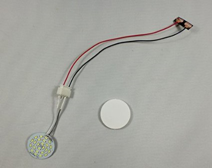

Just watching the video...very bright lights..had a question. .the battery pole attachment..can you buy separate,without the light?that's what I need on mine..I have strobs on my p3p...I'm using a cell phone juice back.."portable battery charger"...for my 5v..I was thinking just using a 12v cig lighter circuitboard and then powering from the battery poles,like yours...
I bought a cheap headlight to get battery pole insert but know my buddy chuck on here took shell apart and hardwired it in
Well I hardwired my strobes in but for some odd reason I lost connection to the battery voltage
