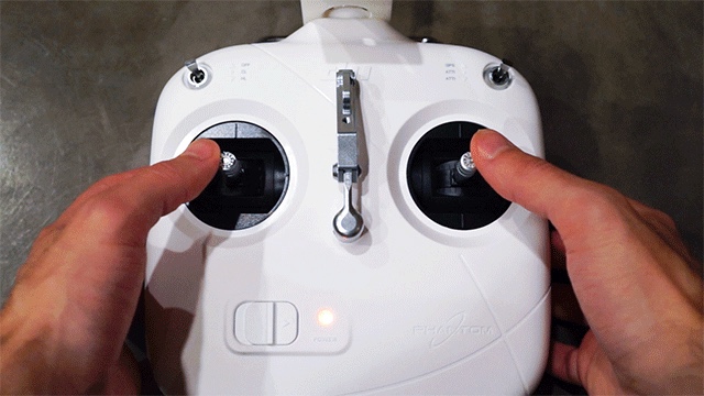

Use a CSC command to kill motors. Bring left and right sticks to either the bottommost inward or outward positions to kill the motors mid flight.

Moving the left stick to 6:00 should stop the rotors, but CSC can as well. As others have commented, I would do a recalibration, and full cold restart. Hover a few feet off the ground and make sure all controls do what they should. The, make sure you can get still get full GPS lockup. Lastly, test its range to see you still have what you should. Finally ...watch where you're going...

Left stick to 6:00 would not stop rotors, CSC did.
