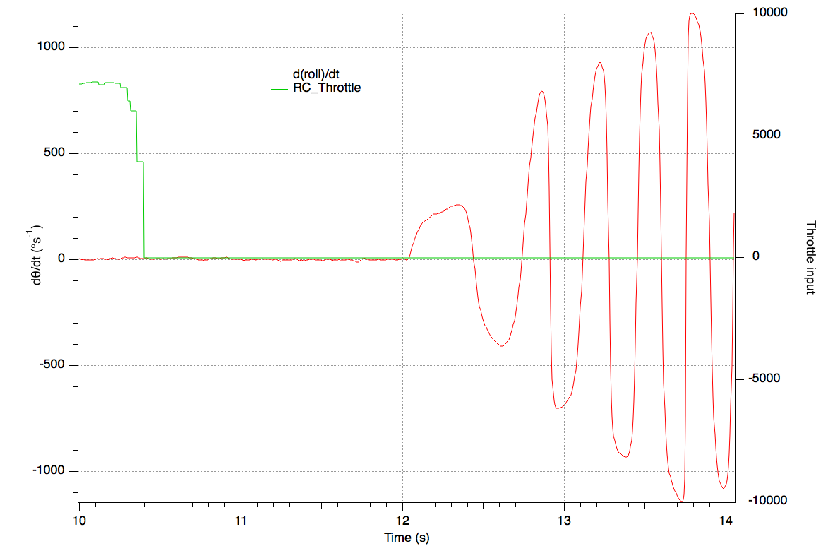

It lost its front right prop at 12 s. In the pitch/roll/yaw data you can see that as a result it pitched forwards, rolled right, and yawed CW. In the motor command data the loss of lift resulted in the FC requesting full power from the front right motor and decreasing power to the left back to correct attitude.

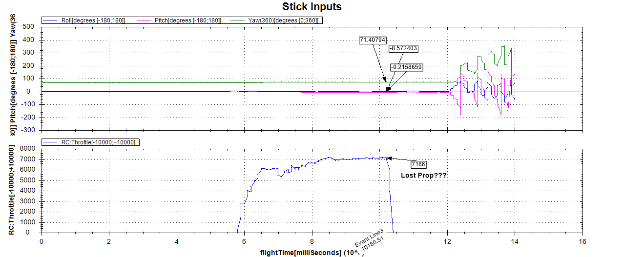

In addition to the above, it appears you may have "accidentally" given it almost full throttle from RC, and that is right at and near as @sar104 mentioned, you most likely lost a prop.
Throttle was centered at 10.4 s, so 1.6 s before the prop was lost at 12.04 s. That sudden decrease in motor speed could well have caused the prop to fly off if it had not been tightened properly.
