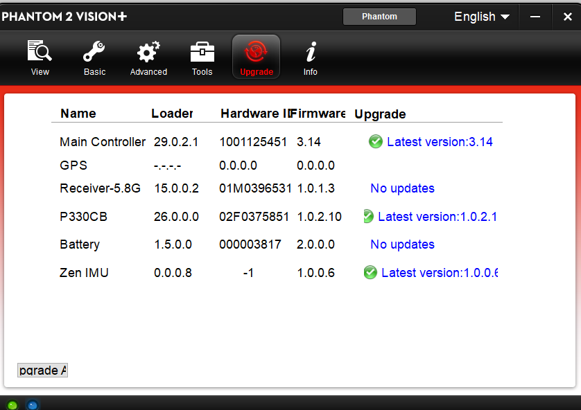

Just got this used P2 V3 V+ that may have been in some kind of crash I don't have much background on it, it has some small visible damage but the gimbal is intact and for the most part it looks like it may have been a minor crash, it came with the updated controller that charges, I've done IMU calibrations and stick on DJI assistant, the battery is at 75 percent it may need replacing. I can bind since I can move the gimble somewhat with the stick, the little green light on the gimble is on. it I haven't been able to get GPS lock, the major issue is even after the controller is on there is a steady gree light on the rear right light, I was outside and didn't get any GPS so maybe the GPS is shot too. no video both on DJI Vision and Litchi, so might be wifi module issue, gimble is responsive, no motors engaged mo matter what I've tried, so probably bad ESC controller, any thoughts on what I should I do? Thanks attached a snip my DJI Assistant upgrade screen it's all up to date maybe I need to downgrade? Also X2 in sticks monitor stays black intead of turning green like X1 after calibration, and the left controller sticks stick in the down position, is that normal?

The GPS puck is damaged, they are the first thing to smash if it lands top down, you should be seeing figures after the GPS in your picture and you arent, NO GPS NO MOTOR START

I just discovered this very interesting long thread DJI Phantom 2 GPS Disconnected (no Satellites) where they suspected it was the GPS puck, than the Naza and in the end it was the whole mainboard, I can get a used PCB for about $50 bucks, beats buying a GPS and Naza only to find out it doesn't fix the problem like it didn't for the other poor fellow. How do I go about examining the mainboard before I go replacing parts that may not need replacing? I forgot to mention the LEDs in the rear left are broken so is that why I'm only getting one green light?
