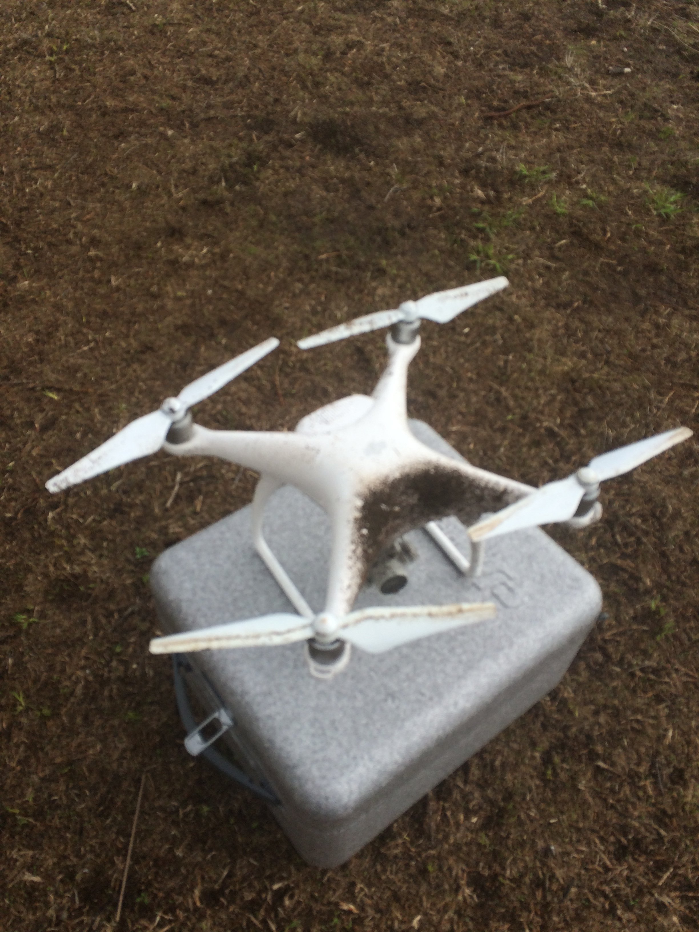

Here's a photo of the bird after it ate dirt. Apologies for the poor photo quality, I was a bit shaken when I took this pic.
