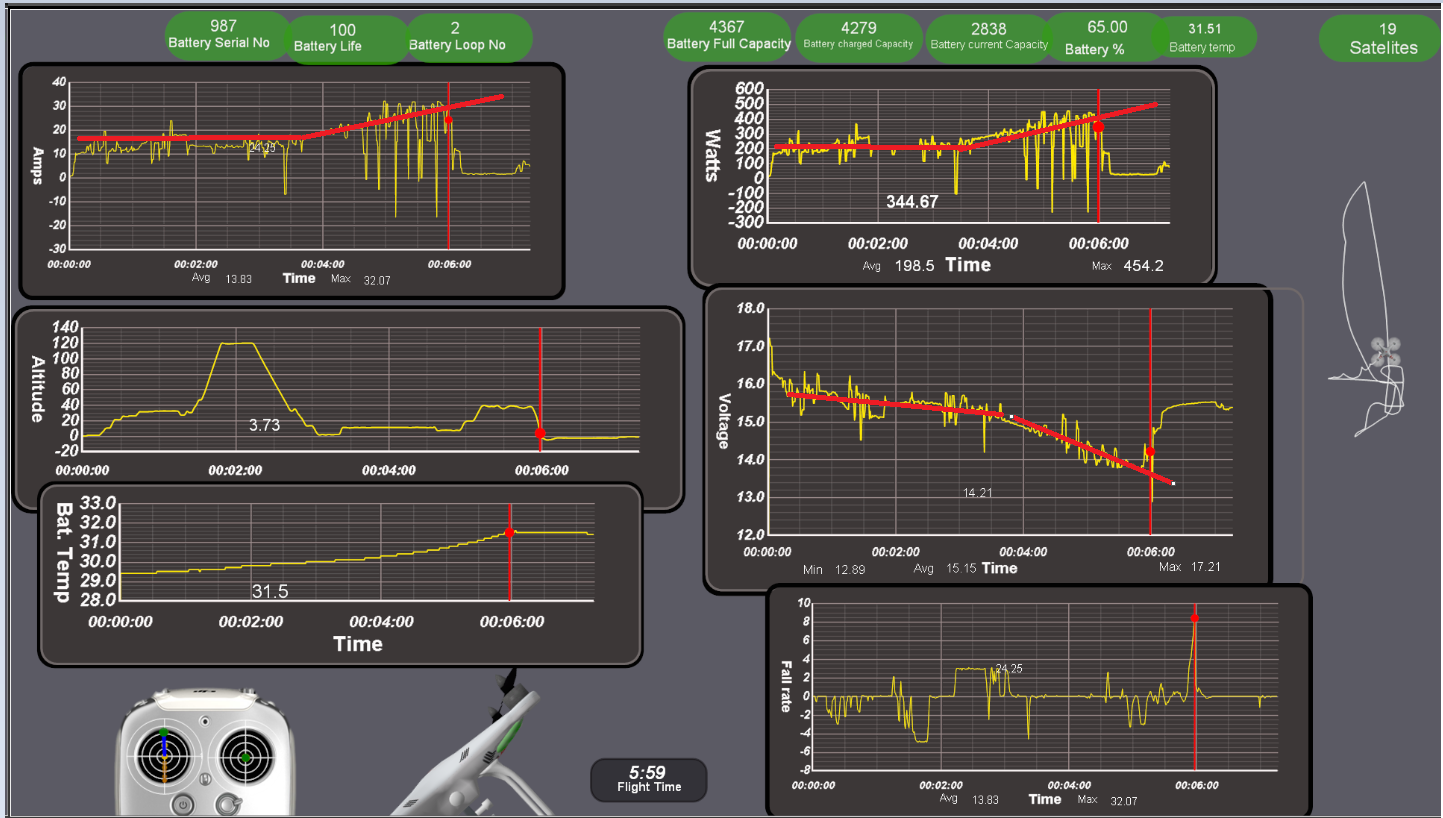

My thoughts are that the props iced up as a result of the low temperature, the excessive moisture in the air due to the fog and the low pressure caused by the movement of the props through the air.
Reactions: MichaelR
Here is some data of that flight taken from the txt log:
The vertical red bar is at 5:59 which is impact time.
I drew red lines to indicate the trend of the charts.
If you check the Amps you will note how amps starts raising at around 3:30 minutes (also lots of negative amps which are unusual error readings).
You will also note voltage graph starts slumping at around the same time. The watt graph starts increasing at round 3:30.
This indicates the Phantom has to use more and more power to remain in flight .
As someone else posted low temp and fog could have led to ice forming and would nicely explain this increase in power
If you post the DAT files of that day if you still have access to them, it will show more data

Hello Luap,
On the Graphs that you are posting, are you manually creating those from the CSV? I have a .DAT file from a crash that I wanted to get looked at, but I don't know of a tool to use. I just sent a message to Bud as well. Any help is appreciated. Thanks, Kevin
Dashware is creating them from the CSV. Post the DAT on google drive or Dropbox and I can have a look.
